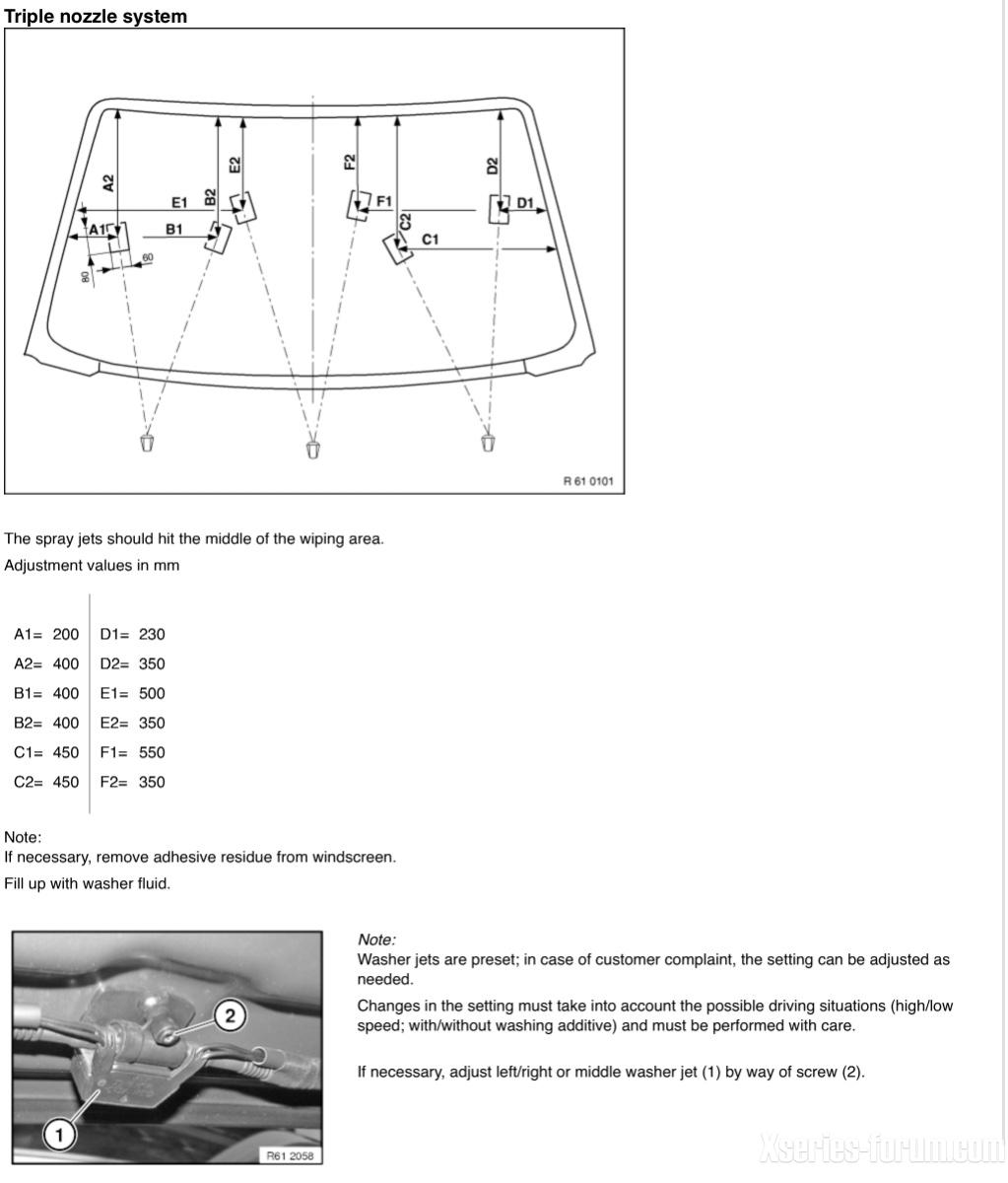

This help…..? It’s for the F25 so should be right.
For your other question, I have only used BMW Screenwash concentrate (bought in 5L containers) after using someone else’s and ending up with gunked nozzles and pumps in my E53 20 years ago. The OEM stuff contains Isopropyl Alcohol that stops bacterial growth (the white gunk) from growing. Smells nice too….

X5Sport wrote: Fri Apr 19, 2024 8:07 am This help…..? It’s for the F25 so should be right.
For your other question, I have only used BMW Screenwash concentrate (bought in 5L containers) after using someone else’s and ending up with gunked nozzles and pumps in my E53 20 years ago. The OEM stuff contains Isopropyl Alcohol that stops bacterial growth (the white gunk) from growing. Smells nice too….![]()
Thanks, I will take a look, but algebra never was never my strong point at school

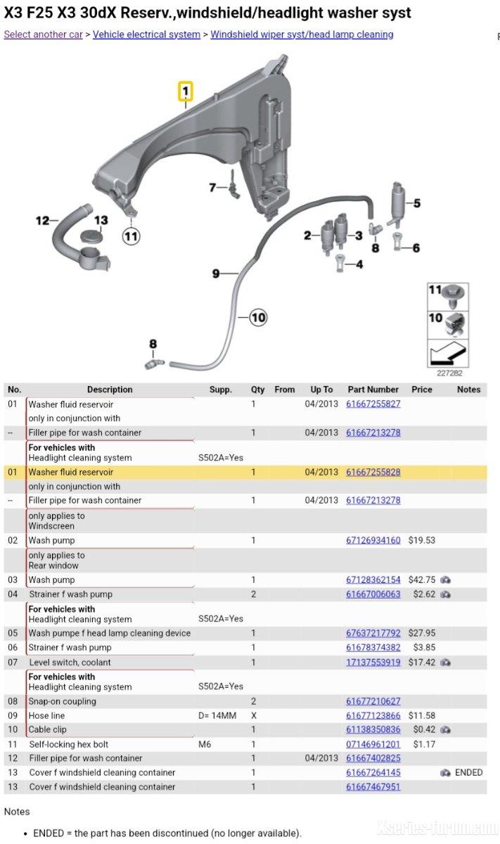

Windscreen washer jets
It looks like the tank sits quite high up in the wing. The pumps you'll need to access though are buried at the bottom.
I fear the exercise will be similar to my experience

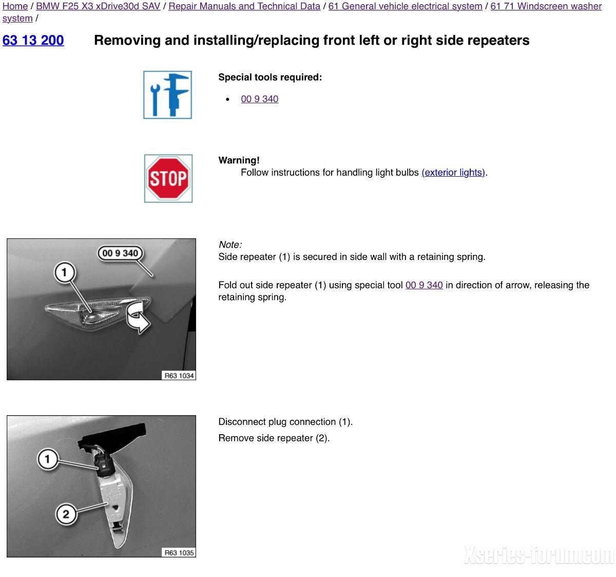

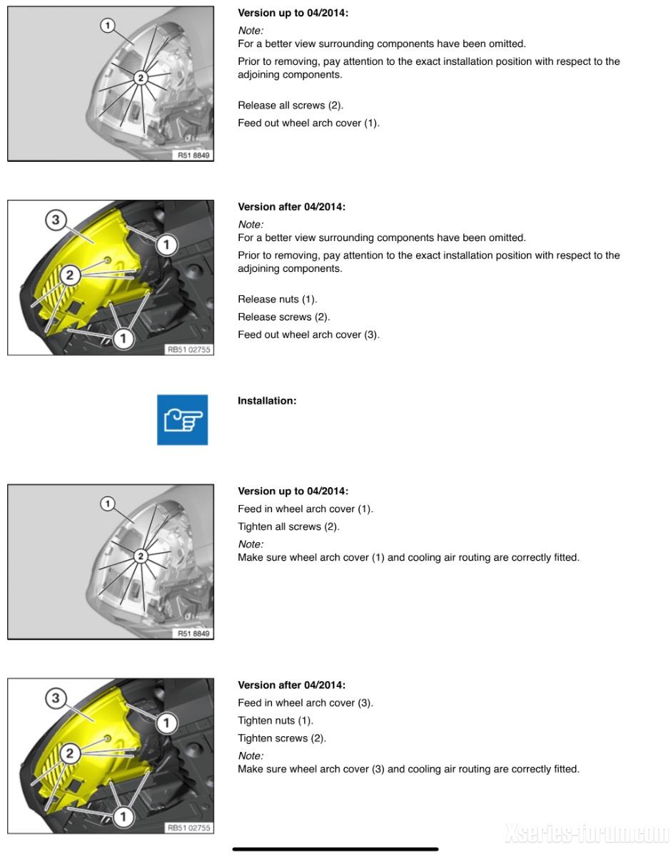

From the good book……
Remove front right wheel (I only have something that says it’s in the right wing)….and for some reason the repeater indicator as well. I assume that would foul the bottle maybe?
Indicator removal: - special tool is a pair of credit card sized plastic trim tools. Wheel arch liner removal (not different years have different ways of fitting! Getting the bottle out and in….
