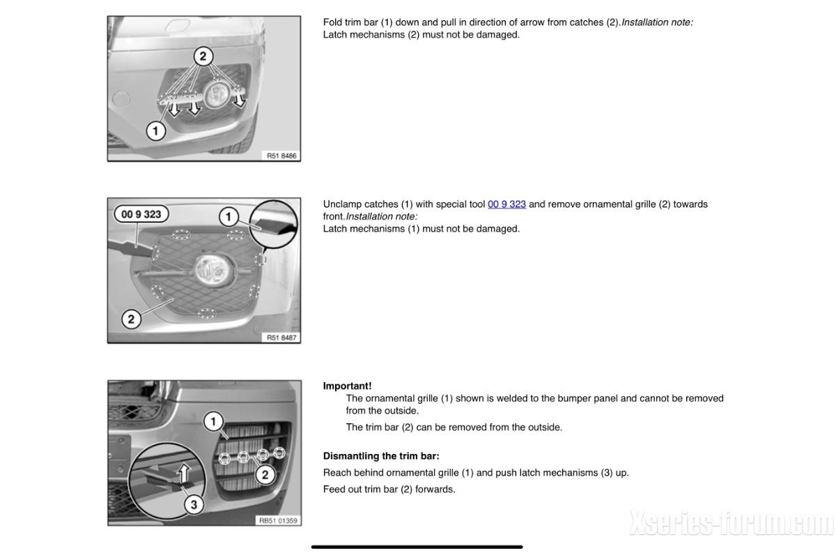

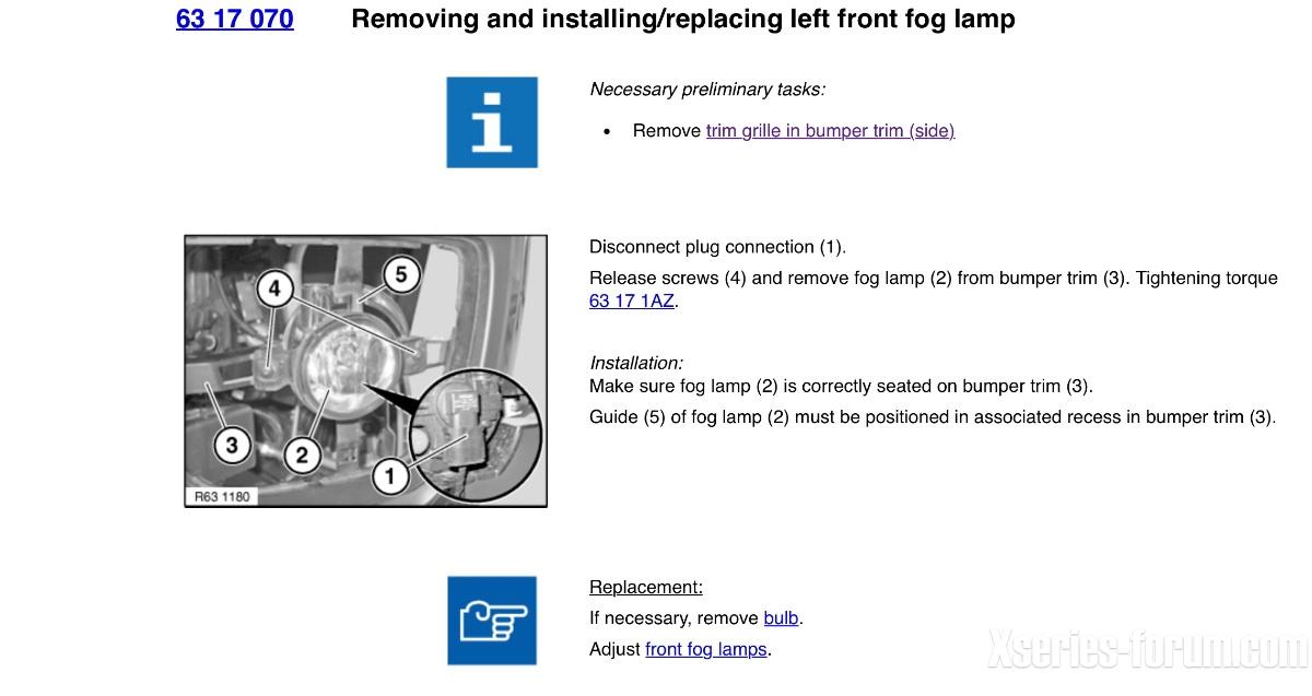

Am i right in thinking there are still free versions for older vehicles? I've done it before but don't recall how to access foglight bulbs on an E71. YouTube has some tutorials, but they don't work on my car.

There are……but this might help?
The special tool seems to be some sort of plastic trim removal tool.

I'm grateful for that, thank you. Thats how i remembered it pretty much, but stage one squeezing and pulling the decor trim simply doesnt work on my car. In recalling i needed the equivalent of the "special tool, i have ordered some plastic spatulas designed for filler which should be thin enough to release the internal lugs.
