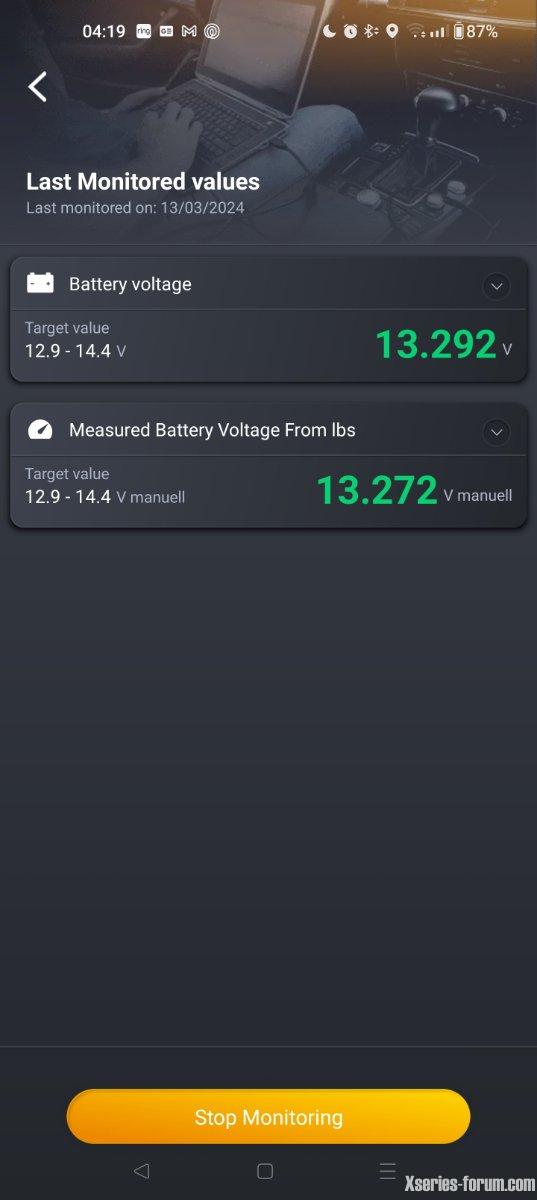

This morning I had no notifications on the dash. I ran Carly and got the following results the first is with the car on and second with the car off.
So, it must be a connection issue. I'll start at the battery any where else if the battery is okay?

The pictures look to be the wrong way round…
The first one is (I think) with the car engine off and the second with it running?
The second one implies the charging voltage is too high. It should be no higher than 14.4V.
Really the only reliable tool for measuring is a multimeter rather than an App (I have Carly as well but still use a meter) and directly on the battery or jump start points (should get the same answer from either). You might find it’s actually fine. The first picture certainly shows the battery volts are good. Measuring via an app with the car on (running engine or not) will be affected by the electronics being ‘awake’. You need ‘no load’ readings, hence a meter.

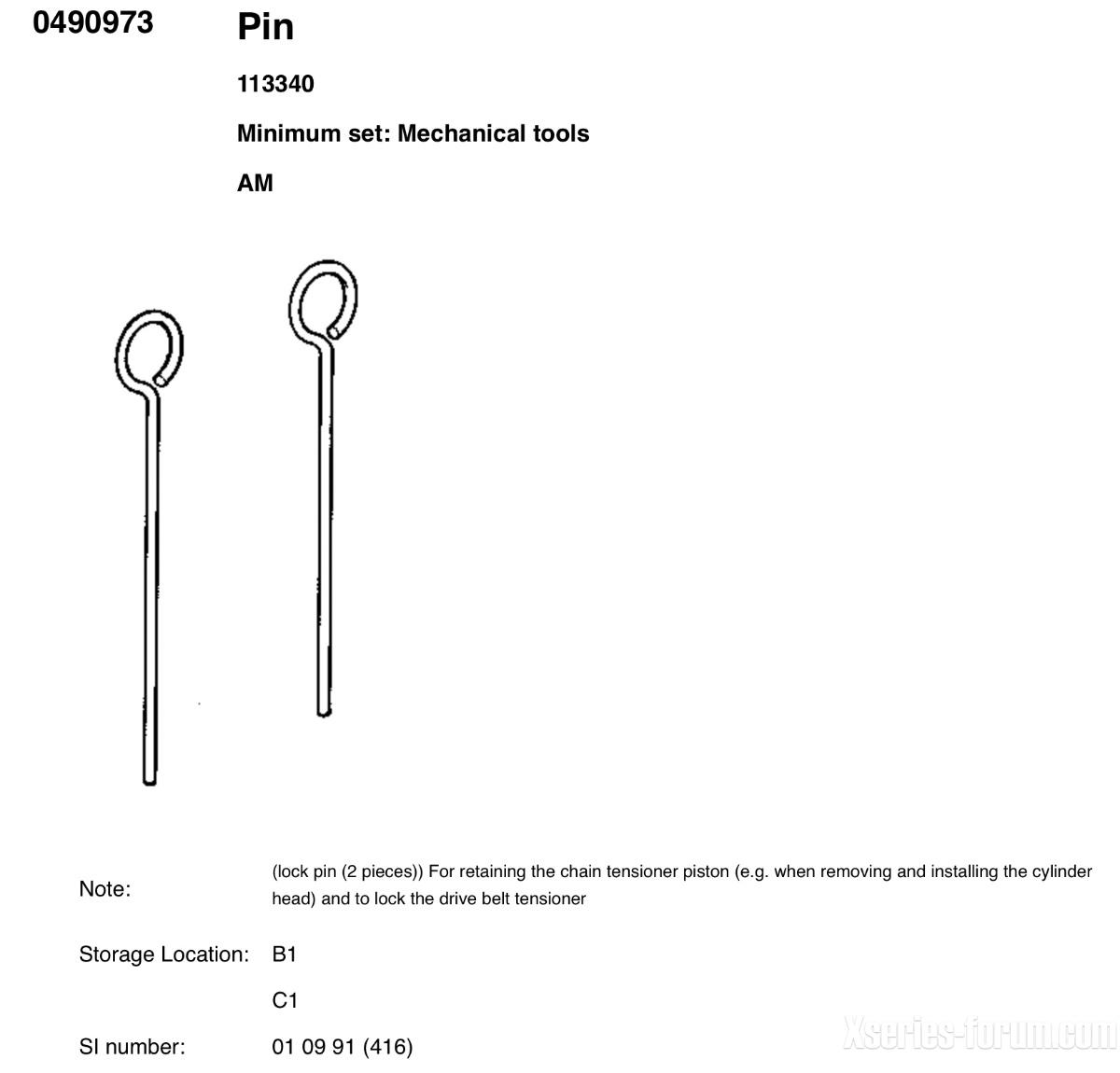

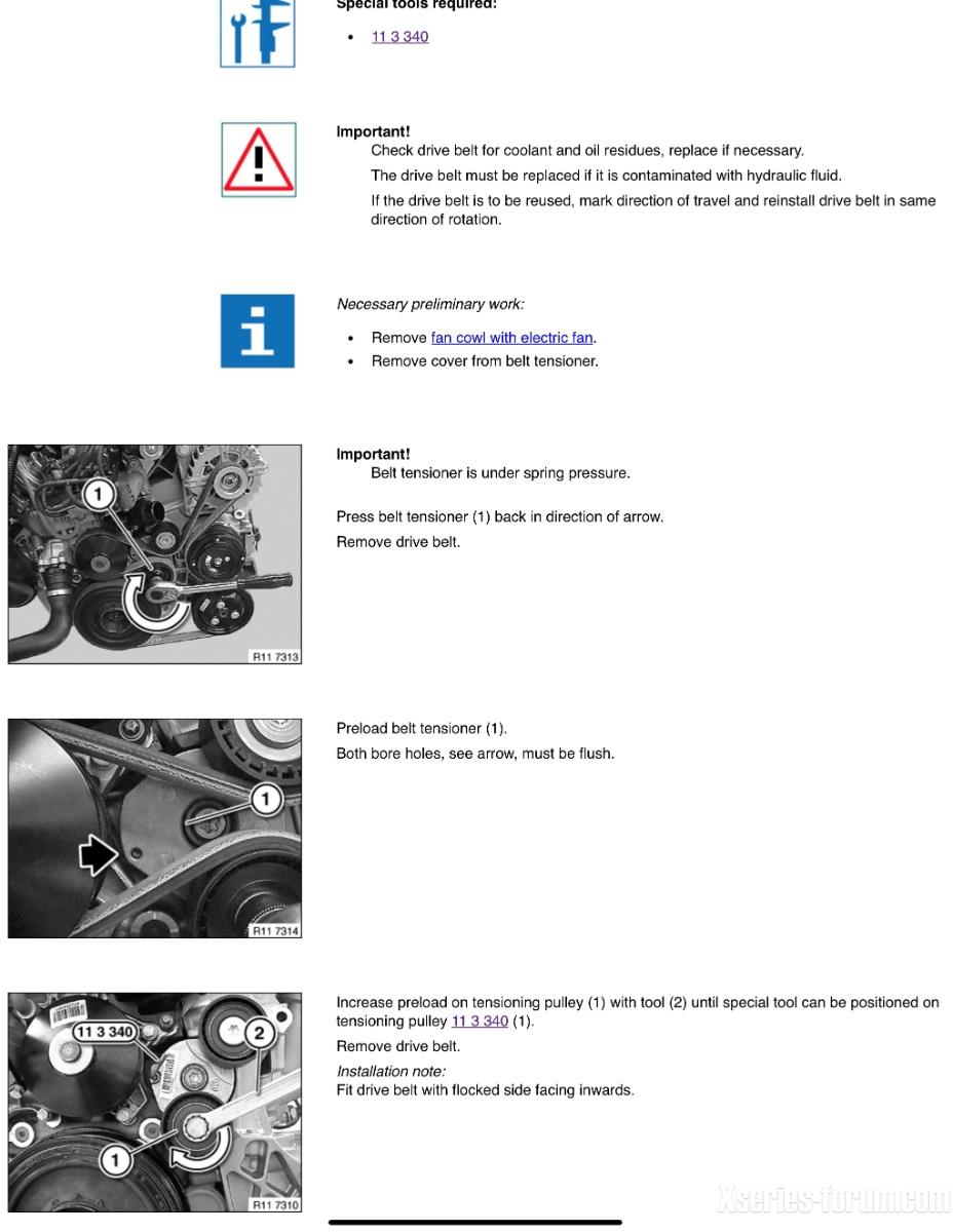

Change procedure - if you need it…..
Belt tensioner
Tightening torques -
12 31 Alternator with mounting
Tightening Torques
Type Thread Tightening specifications Torque
1AZ Alternator to holder
N57 D30 O 0 / N57 D30 T 0 / N57 D30 S 1 M10 38 Nm
2AZ Deflecting element to belt tensioner
N57 D30 S 1 M10 55 Nm
Special tool - basically a steel rod to lock the tensioner
Tightening Torques
