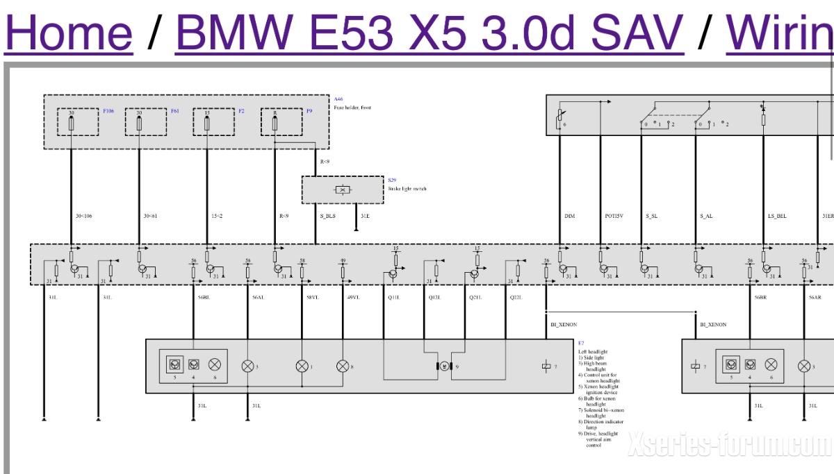

I'm trying to swap my oem halogen headlights for oem xenon but they aren't powering on. Wondering if anyone else has down this same mod and if any additional wiring involved?
2005 E53 X5 3.0D SE
Posts: 19186
Hi
Post by X5Sport » Tue Oct 24, 2023 5:26 pm
Seen your other thread. Have you got ballasts installed?
Have you got all of the parts listed here: https://www.realoem.com/bmw/enUS/showpa ... Id=63_0833

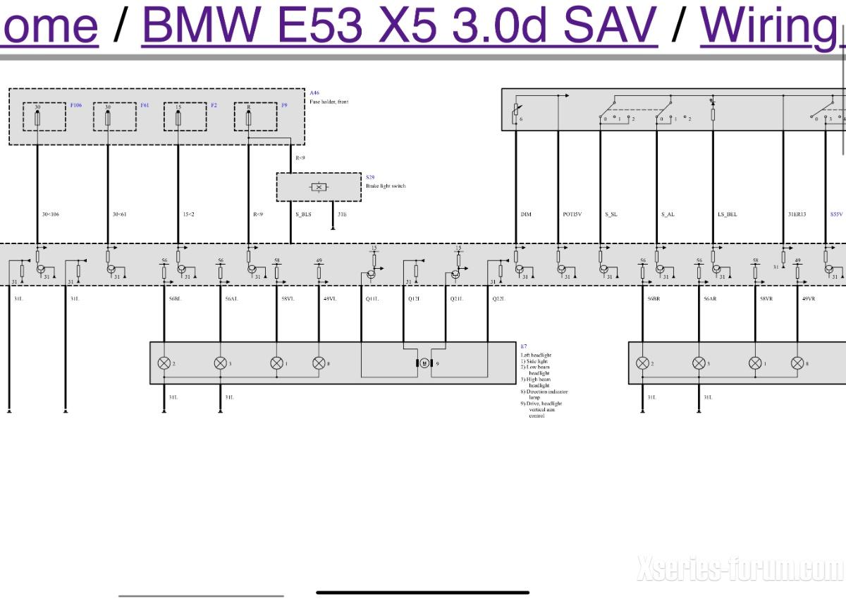

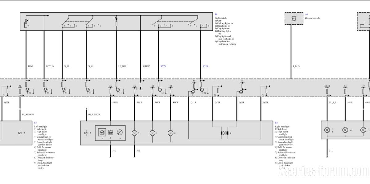

Wiring diagram as best as I can find…..these are for Bi-Xenon lamps….
Posts: 19186
Hi
Post by X5Sport » Tue Oct 24, 2023 5:40 pm

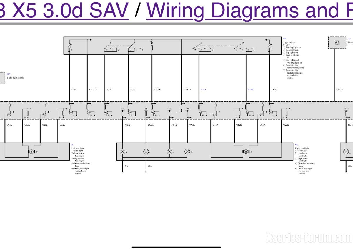

And these are non-Xenon….
These don’t have connections 4, 5, 6, 7.

X5Sport wrote: Tue Oct 24, 2023 5:40 pm And these are non-Xenon….
Hi X5Sport, do you have higher res copies of the wiring diagrams or point me in the direction of where to find them please?
Thanks
Jazz
2005 E53 X5 3.0D SE
Posts: 19186
Hi
Post by X5Sport » Fri Nov 03, 2023 11:35 am
Sorry I don’t. That’s the copy I have.
