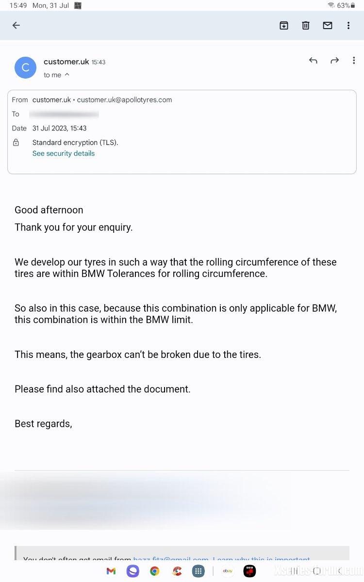

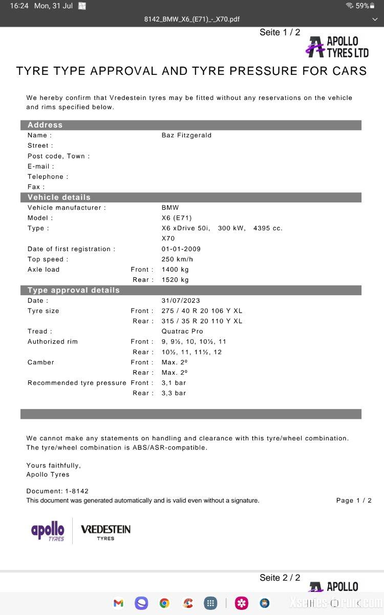

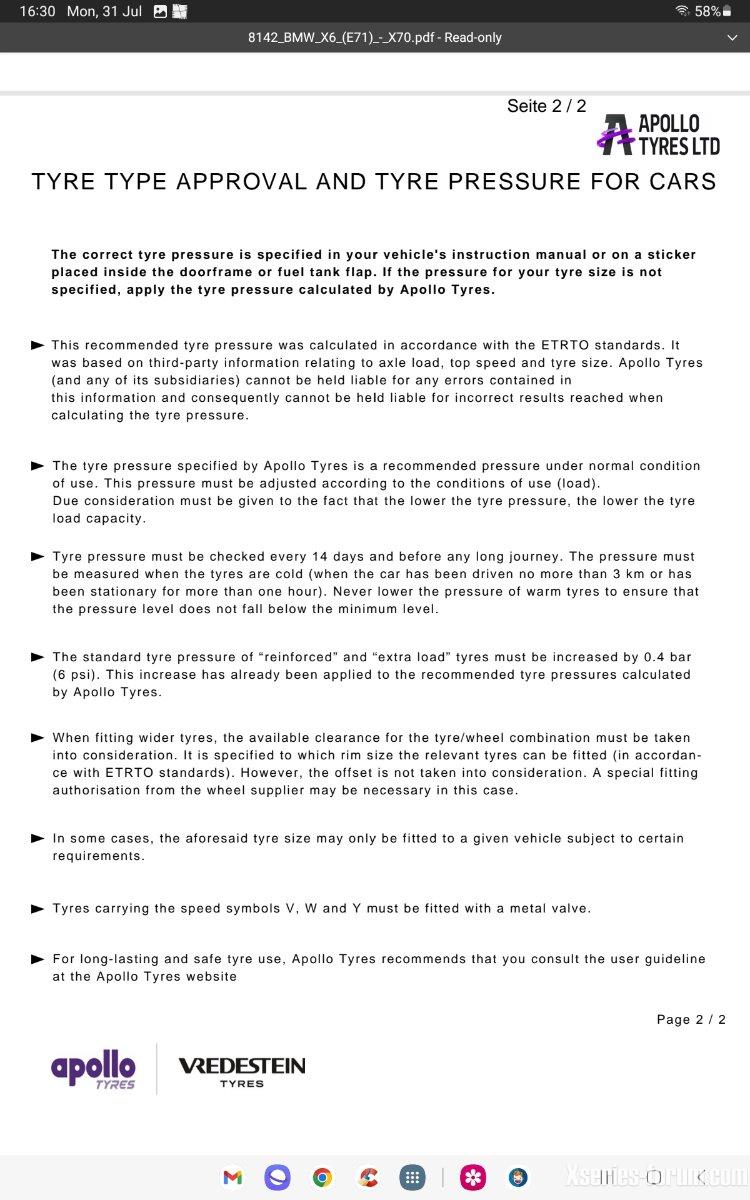

Further endorsement from a much earlier post from the makers, that these tyres are matched for use on BMW. Wrong engine is noted but ill not bother on that.
I have way too many sets of wheels, its time to rationalise. All weather is the obvious solution. I'll keep the full winter spec Pirelli's for the time being, just in case.
