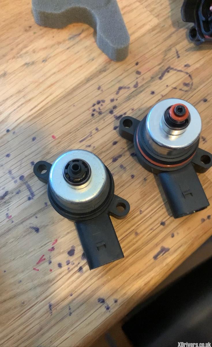

Post by Bch06 » Mon Dec 28, 2020 2:53 pm
I will be going tomorrow to the dealer as they were closed from last 4 days, I will again put my question to them to explain me why do they think it might be the compressor, Since they are not certain and If they refuse to answer my question can I disagree to pay the diagnosis charges? But I still want the problem to be fixed.
I have also done a lot of research and found out that the air compressor not only pumps air in to the bellows, it also has a function to purge the air and in my case that is the problem, even when I run the deflate cycle through Ista D the car doesn’t deflates, so I guess it is the deflate function which is playing up. However when I last opened the compressor I didn’t see any sign of water but I still replaced the desiccant silica gel beads, it must be the solenoid valve which is stuck closed and doesn’t let the air purge.

Post by Bch06 » Sat Jan 02, 2021 1:56 pm
I went to the dealer, so I can speak to the technician, however they refused to let me speak to the technician, I did argue with them about the diagnosis but in the end I decided not to waste my time and more money and just paid the £99 diagnosis fee and got the car back.
From my experience I say dealers are useless, they only told me what the see on the computer, which I already knew from ISTA D. They quoted me £850 for the compressor & £250 for install the compressor (really to unscrew 3 nuts and screw them back £250) yes unfortunately they are the biggest ripoff
As I previously informed on this forum that I was researching on how the compressor works and found out that the compressor actually also has a deflate function, which strangely not has been discussed on any online forums, I decided to order a part called “Air Compressor Vent Valve” it’s available on online shopping websites and it costed me £30
Today I took out my air compressor unit to reply the vent valve on the compressor, when I compared if with the new one I could easily tell that the new one was moving freely and the old one was stuck closed, I have taken few pictures which I will upload, I fitted back the compressor unit on to the car and went on a long drive, no errors, ride height is on correct level and smooth drive. Yayyyy
Although it took me quite long to resolve this issue, but in the end hard work and research paid off, thank you everyone for all the advice.

Good work and if that's it a grand saved! BMW were sort of right in that a new compressor would fix it but at huge cost.
Definately the first time I've heard of this vent function so fair play and as for 250 to fit a compressor it's the silly hourly rate and as we often suspect the price isn't always reflected in the amount of expertise provided :headbang:
