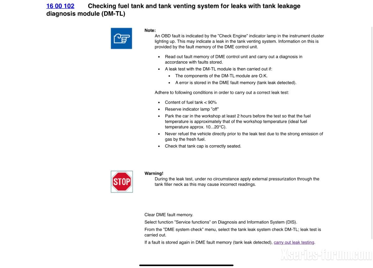

Petrol engines pressurise the tank slightly and we know petrol evaporates at a much lower temp than diesel (so it needs no valve)
The fuel tank has a pressure control valve system built into the fuel cap. It might be that is leaking (as in not holding pressure). The only way to check that is with DIS and a special toolset that connects to it. You also have to pressurise the tank by 0.3Bar (4.2psi) and see if the pressure holds. Not possible to diy safely. Changing the fuel cap would prove/disprove it.

Technical description of petrol fuelled tank system…..
Petrol engine fuel supply systems
Fuel system
The fuel pump in the fuel tank generates pressure in the fuel system, which is set by the electronic pressure control valve to a certain level.
Tank-venting system
The tank safety valve is a closed system that is bled via a carbon canister. The carbon in the canister is stored as granules. The large surface of the granules traps the fuel vapour, that occurs in the fuel tank. The carbon canister needs to be refreshed regularly in order to be able to continue to store fuel vapour. This is done by flushing it with fresh air from the intake pipe. This process is controlled by the engine control unit.
Fuel system
Tank-venting system
