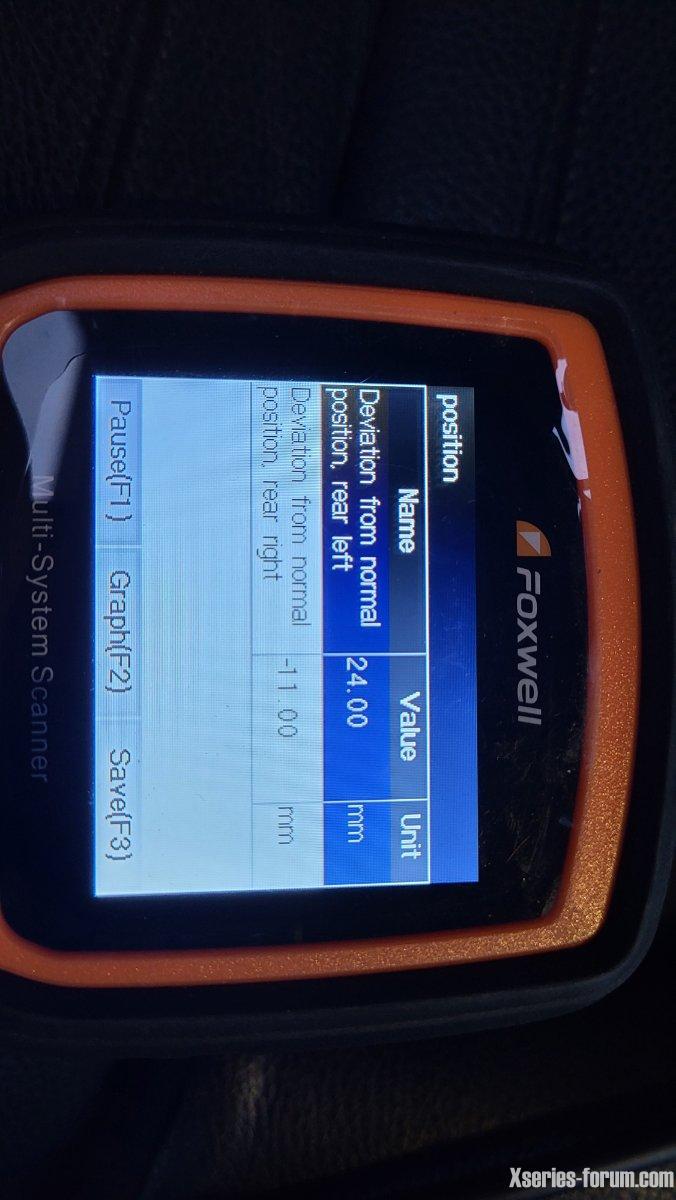

I have an issue where the rear right sits noticeably higher than the left when parked facing downhill on my the drive. No fault codes relating to the issue.
I deflated and inflated the rear airbags using my scan tool and then took it for a spin while monitoring ride height data.
The suspension seemed to behave itself with the ride height only being out a couple of mm from "normal ride height"when driving in a straight line.
I reversed back onto the drive and got the readings in the attached photo, which are worse than when I started.
Anyone any ideas?

So I have done a few longer journeys with live monitoring of the ride height and, other than variations when cornering or rough surfaces, the ride height is the same for both sides. And when parked on the flat.
Just seems to be when reversing onto the downhill facing driveway. Go figure!!!😀

If I reverse up my sloping drive from the right my right rear wheel sits far higher in the arch too when parked so I wouldn't worry about it if no codes. :thumbsup:
