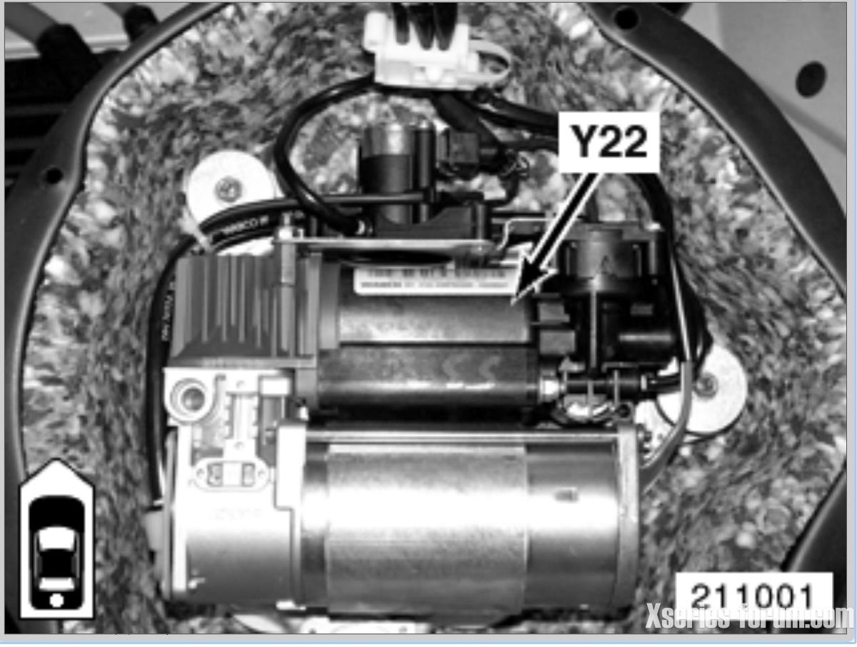

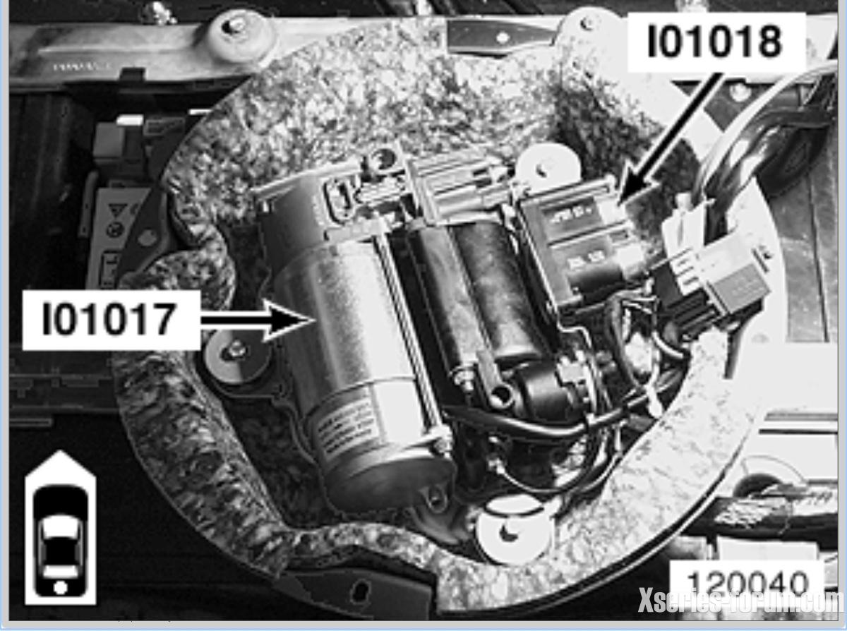

I can only see that the parts list has different numbers. It doesn’t show the actual pump, just the ‘dome’ as a complete assembly.
The air supply control unit is also different. The 4.8is has a separate valve block assembly for 2-axle suspension that isn’t shown for the single-axle self levelling option.
I’m going to hazard a guess that the compressor itself may be more powerful? It has to fill a pressure reservoir/accumulator that feeds the front wheels via this added valveblock.
It just refers to replacing the entire assembly. We know BMW don’t fix, only replace!
Edit - images of the pumps….not sure it’s a huge help. There are some differences between them.
2-axle suspension Single axle (self-levelling)
