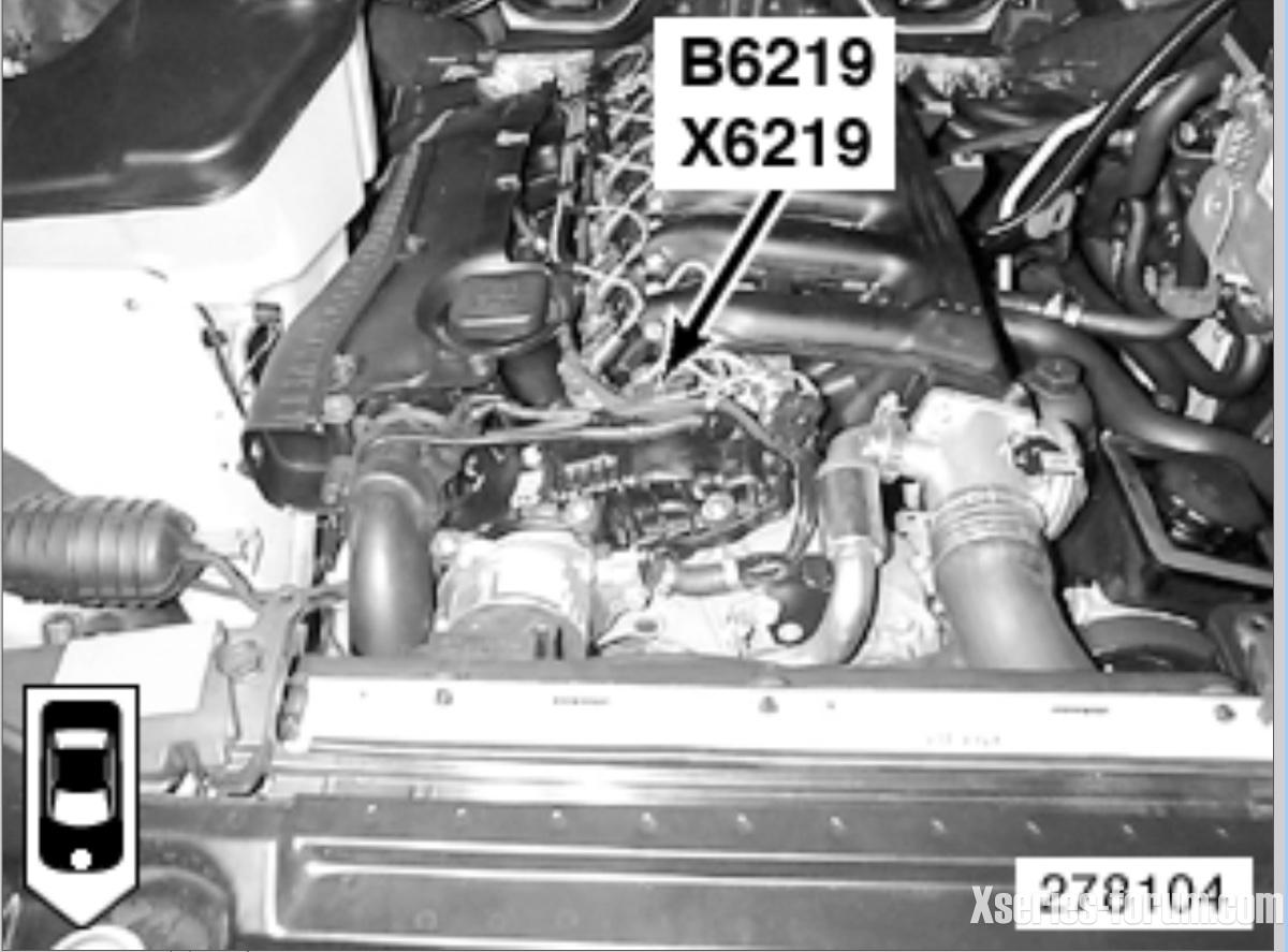

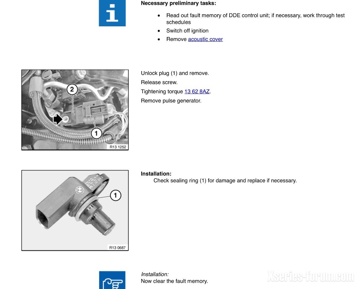

Posts: 19132
Intermittent starting problem.
Post by X5Sport » Thu Feb 16, 2023 7:17 am
This help?
Numbers below are for the Hall Effect sensor and connector.
Al4693
Posts: 24
Joined: Tue Jun 13, 2017 11:41 am
Location: Cheshire
Post by Al4693 » Thu Feb 16, 2023 8:09 am
That is very helpful. Thanks both!
