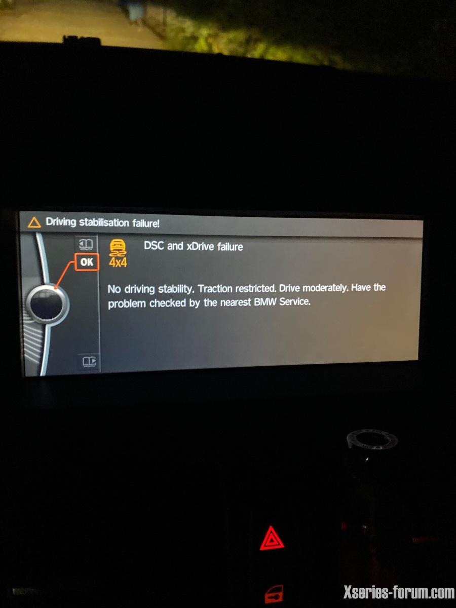

Hello
Dear All Members,
Do you have any experience about DSC light and X Drive Failure in X6
After appear that light , Engine was Vibrate and speed is going down but after stopping the ignition and restart back those light not appear.
After a few minutes, those light appear back.
So please kindly help and share your experience.

A code scan will tell you but it could be one of the ABS sensors.

You need the codes read, this has happened on here before and it was down to a steering angle sensor which was reset and all worked fine.

Ive got this, had front of car off ground to look at brakes, I have just done code read and clear, reset steering angle, leaving it for a bit to settle
