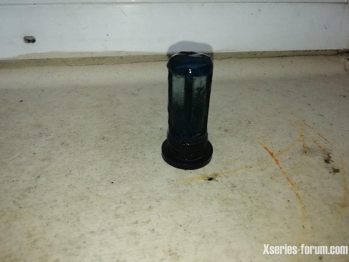

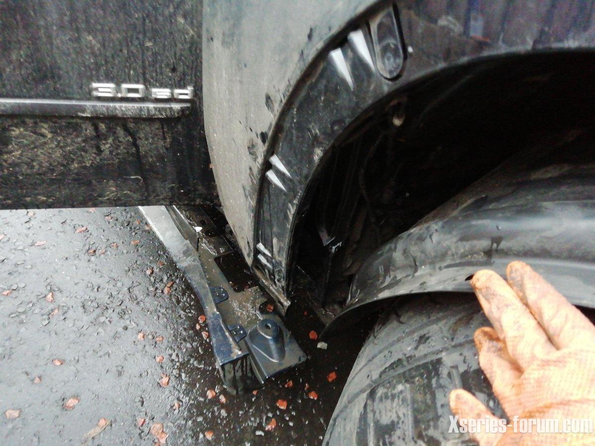

Got the washer pumps out this morn and all 3 filters cleaned. You need to pull the side skirt out to get to the bolts in the bottom of the wing which we're very rusty and one c clip broke which left it nut spinning round unable to undo :headbang: I got it held with my third hand and a screwdriver to trap it in the end. The little plastic wing tab for it has come off but no big deal for now. The liner only needs 3 m8 bolts and a plastic m10 nut and it will come back enough to access after you take 4 torx bolts of on the door post and a star screw out under the windsceen trim. I loosened all the wing top bolts but not sure you need to apart from 1 under the screen. The rear screws for sideskirt would not undo heads rotted off but opening the 2 doors and pulling it away at the front after depressing 2 tabs in the wing gave enough room. The sideskirt has a bolt underneath the sill you could miss too.
The filters were very slimmed up but.cleaned up fine. I replaced the pump but suspect the original was OK but don't want to be in again. Gave the tank a good flush and a lot of green sh*t came out :thumbsup:

Of course it rained halfway through the 2 hour job :headbang: Top is the headlamp wash which still worked the screen pump was much worse. You can see the 2 front tabs in the side skirt in the lower pic.
After I tested it I found the passenger jet or pipe is cracked and water is pouring out of it a job for some other day :rofl: car needs a wash its absolutely bogging now :D
