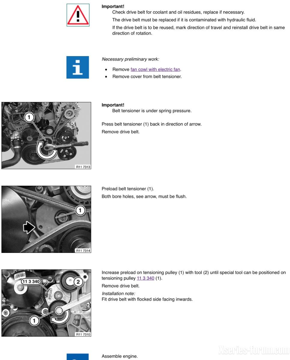

The good book suggests you need to get the electric fan & cowl off and there’s a special tool (a long steel pin) that has to be inserted in the tensioner to get it out of the way (by rotating the pulley below it clockwise thereby increasing the spring loading on it) and for some slack before fitting a replacement belt.
It doesn’t look difficult but there’s very little room to play with. It might be possible to get into the gap without removing the fan cowl.
Image for X6 with the same engine.

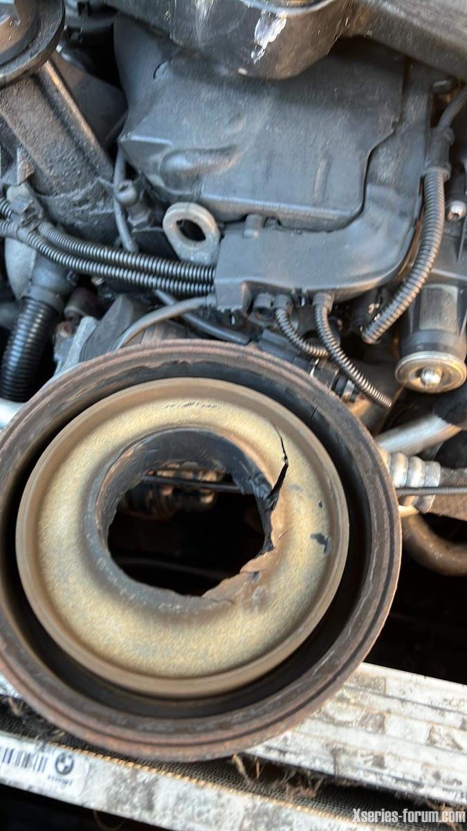

Just had a look and lower crank pulley has failed. Looking at eurocarparts they want £499…wtf

I confess I'm not sure exactly what those images depict but it sure looks broken

Its basically the crankshaft pulley which has split into two parts where the rubber joining them has deteriorated, split then separated.
