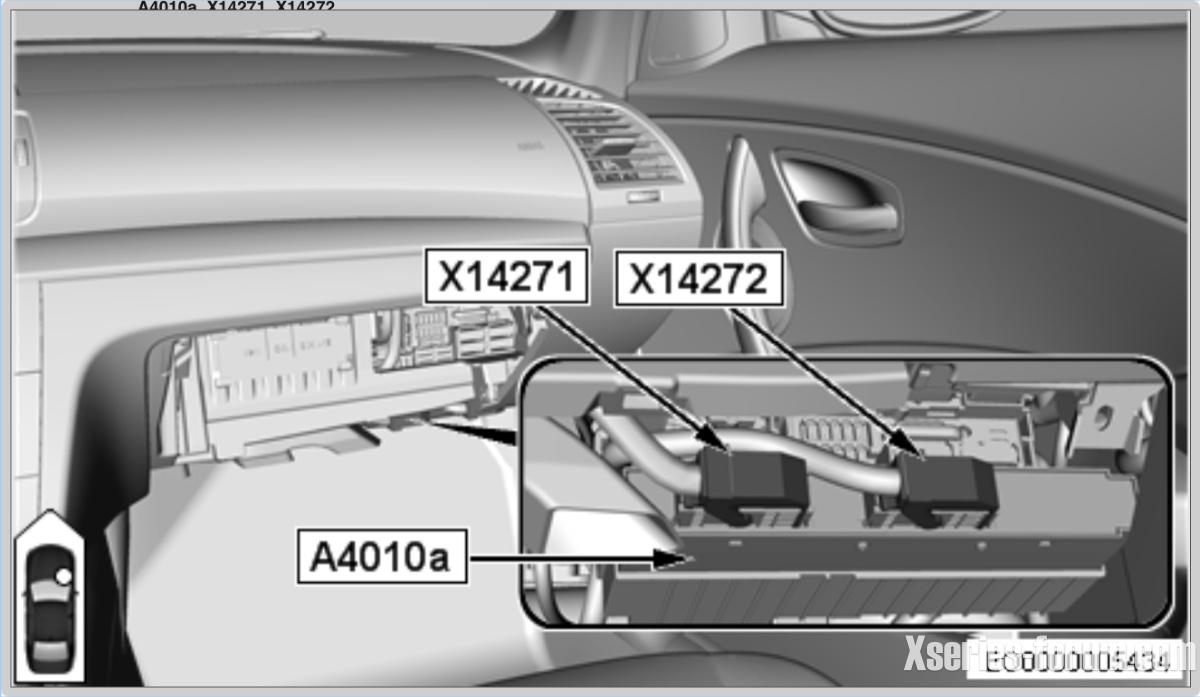

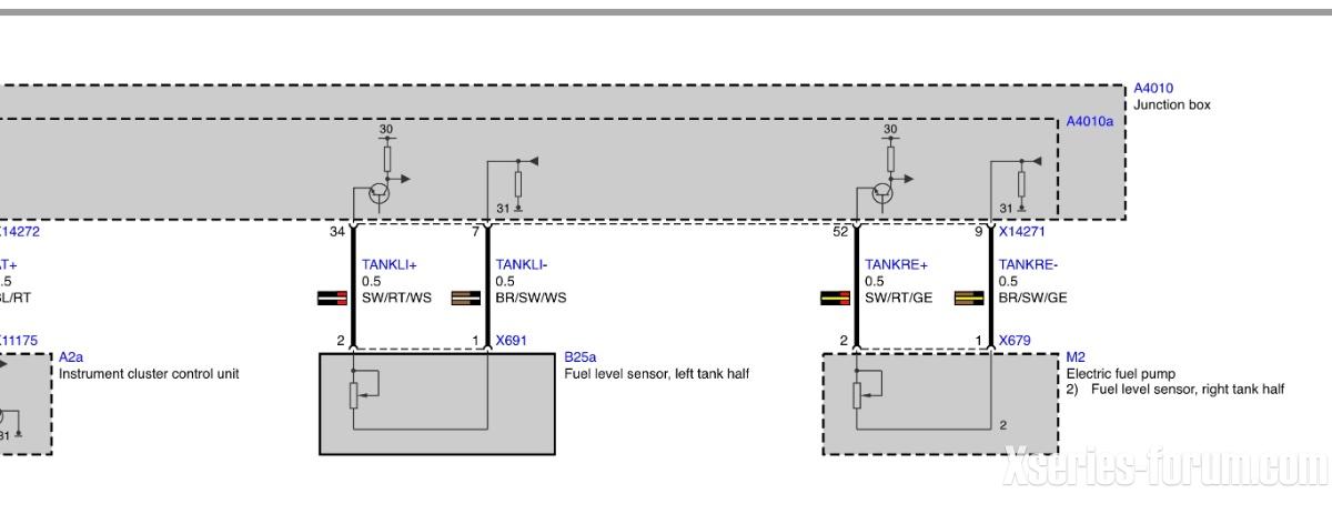

First thought would be wiring between the senders and instrument cluster itself. The wiring for the sensors ends up on the back of the fuse box in the front. Block A4010 and A4010a. Plugs X14271 and X14272. Images for LHD so just reverse them for RHD.
If nothing obvious then it might also be worth having an error code read check done as it may be a module fault. The connections from A4010 go direct to the instrument binnacle (it’s a computer module itself).
