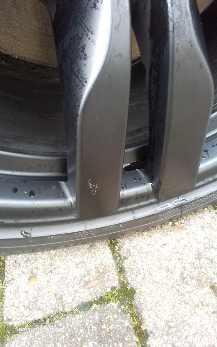

I'd not mentioned if before but during the cars recent dealership visit, this happened All easilly sorted as it was a main dealer, they paid for its full refurb although I had to remove and refit the wheel as powder coating isn't undertaken by them, it had to be outsourced to the business who'd done the set originally. Overall not much fuss although a tad inconvenient.
