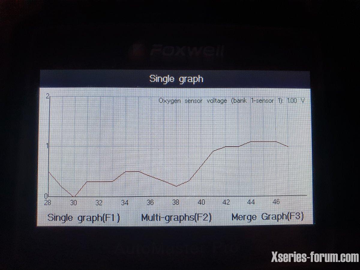

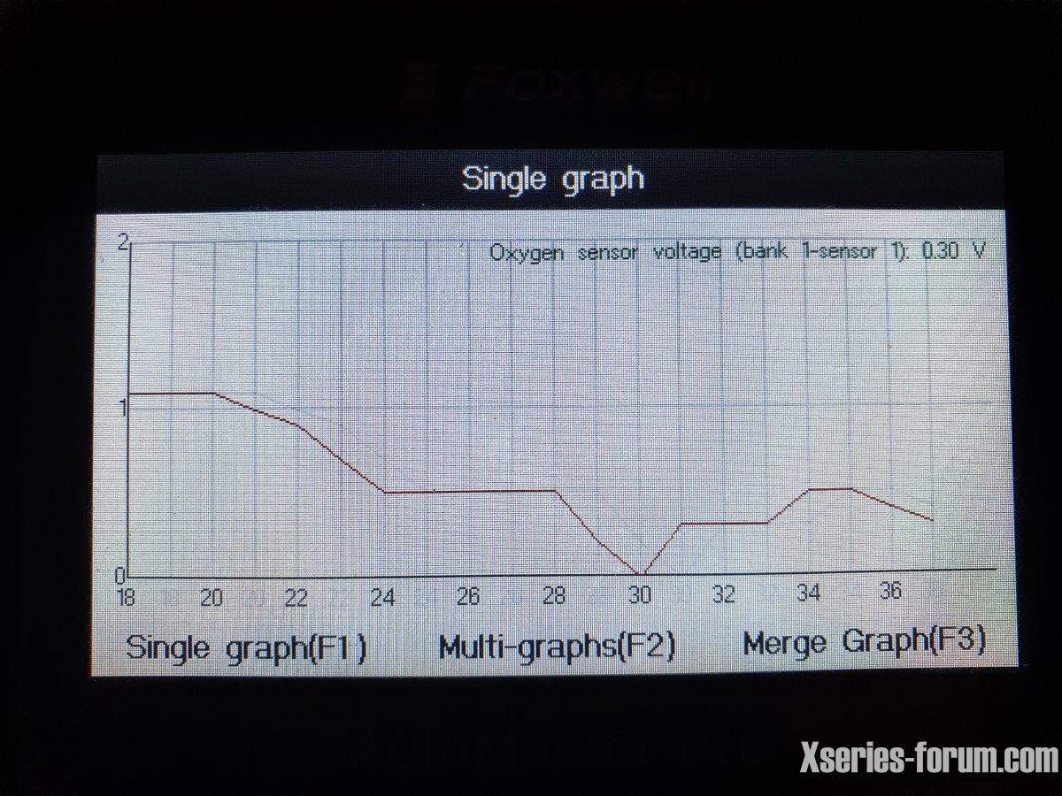

I am in need of some of your wisdom. My x1 has started drinking fuel for the past 2-3 fill ups and it feels as if its still got the handbrake on like its holding itself back. There are no codes present.
I've had a look at the live data and the only thing i can find that looks not right is the lambda sensor reading.
From what i know about 02 sensors data that i have seen from other cars in the past the data should look like this from a before cat sensor (B1S1)Image

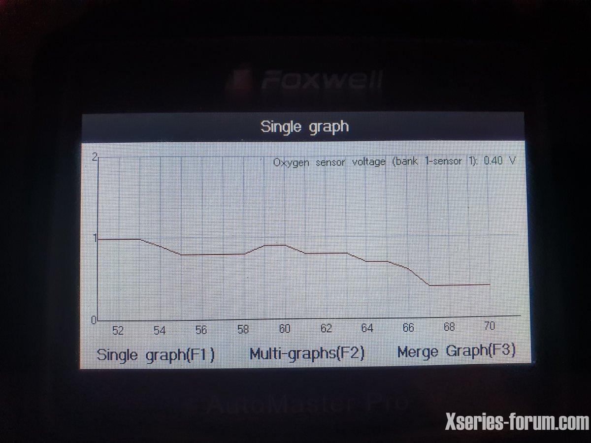

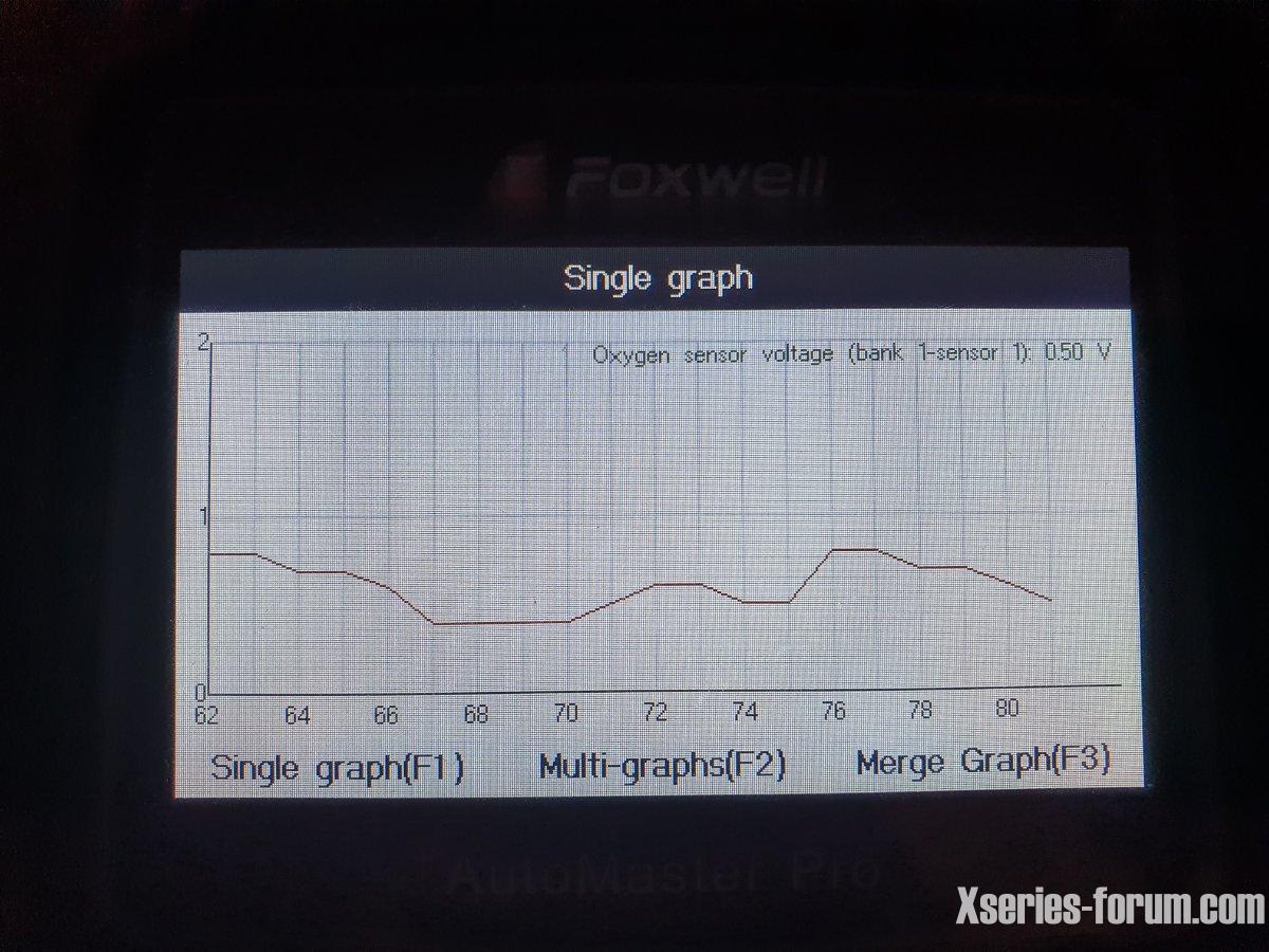

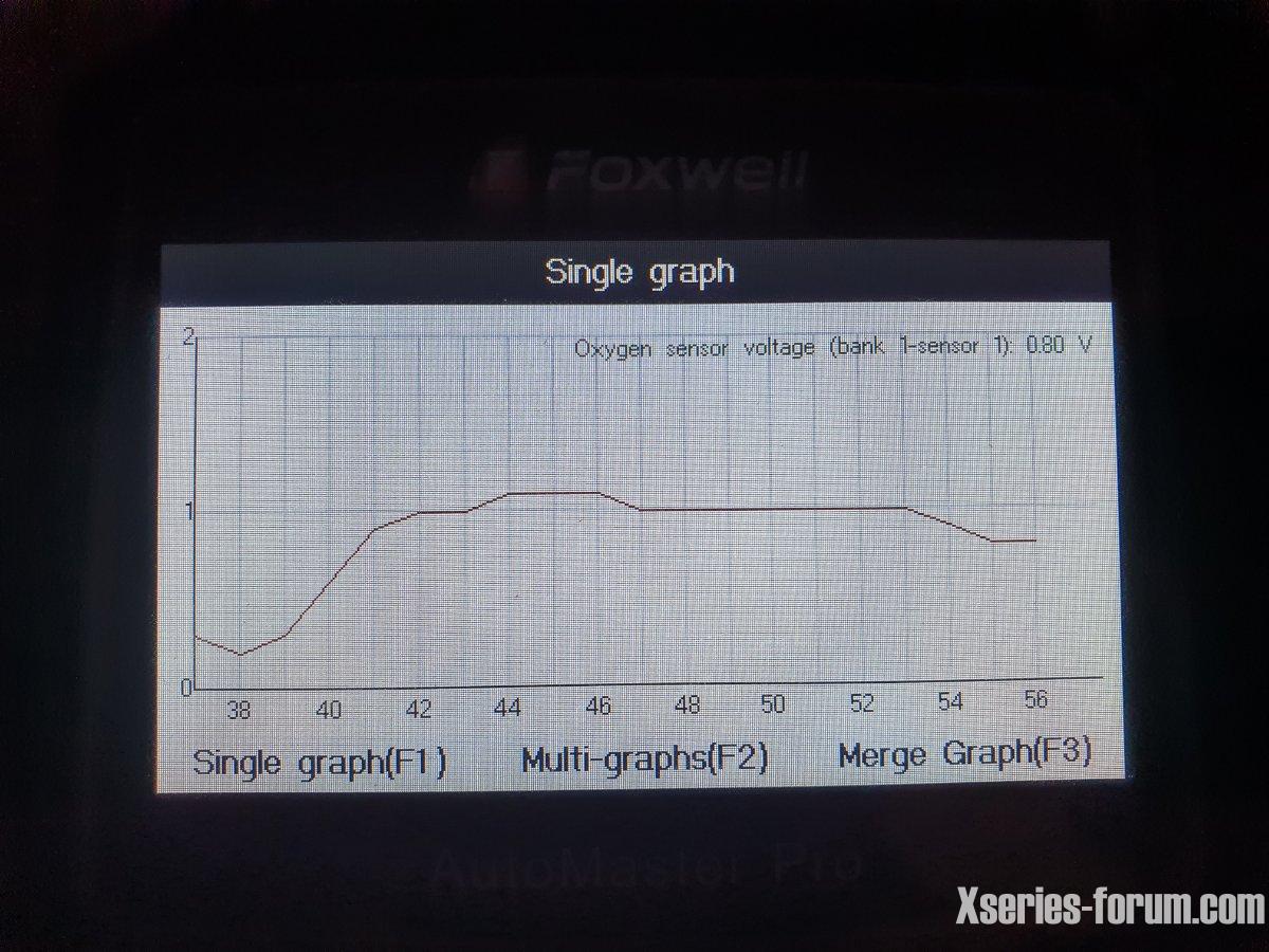

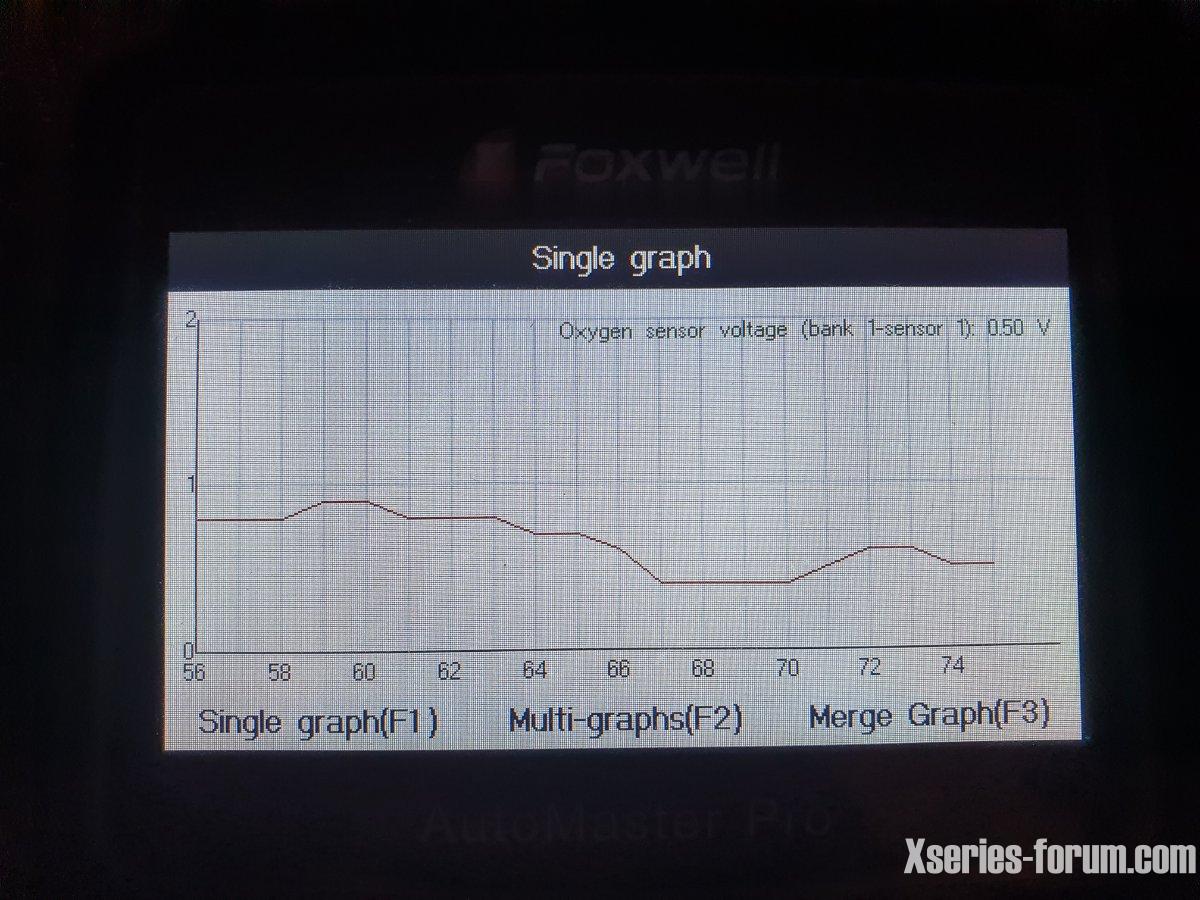

The sensor on the car is reacting more like this. What i don't understand is if the sensor was reacting slowly wouldn't that set a code or is it just for total failure of the sensor and a lazy sensor would not set a code.

No its clean, ive been having a look around and the X1 seams to use something called a wideband o2/lambda sensor and the data that they send is completely different to a standard sensor.
From what i can fine is that a standard o2 sensor uses 2-3 wires and a wideband normally uses 5-6 and the one on the x1 uses 5 so i am assuming that it is a wideband.
Ive found this quote regarding wideband sensors and it seams to match what i am seeing with the slow curve in the live data. So i can only assume that the data i have is correct and the sensor is operating how it should so i am going to turn my attention to finding something else that doesn't seam quite right.
Dose anyone have any info regarding base values ie airflow sensor readings ect as that would be very helpful. I cant seam to find anything like a Workshop manual ect for the x1 e84 20d.
