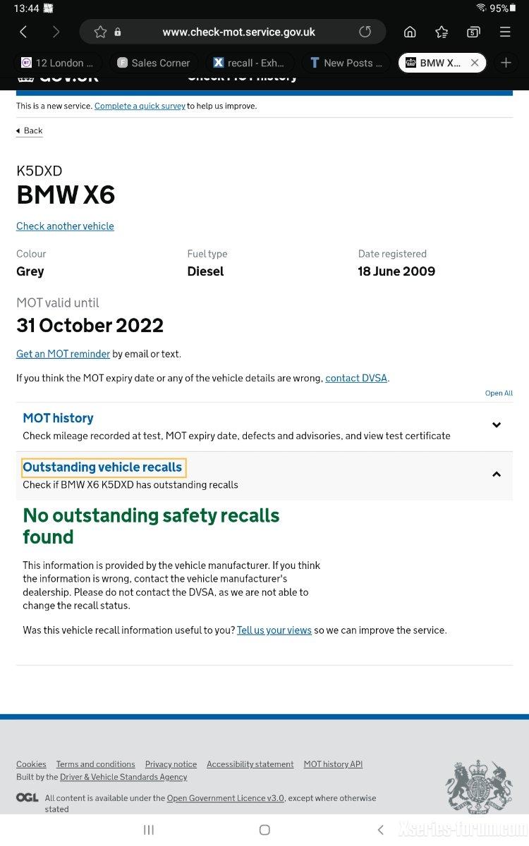

recall - Exhaust gas recirculation
Post by sapphireblack » Sat Sep 03, 2022 11:48 am
Nothing on mine so far 🤔
