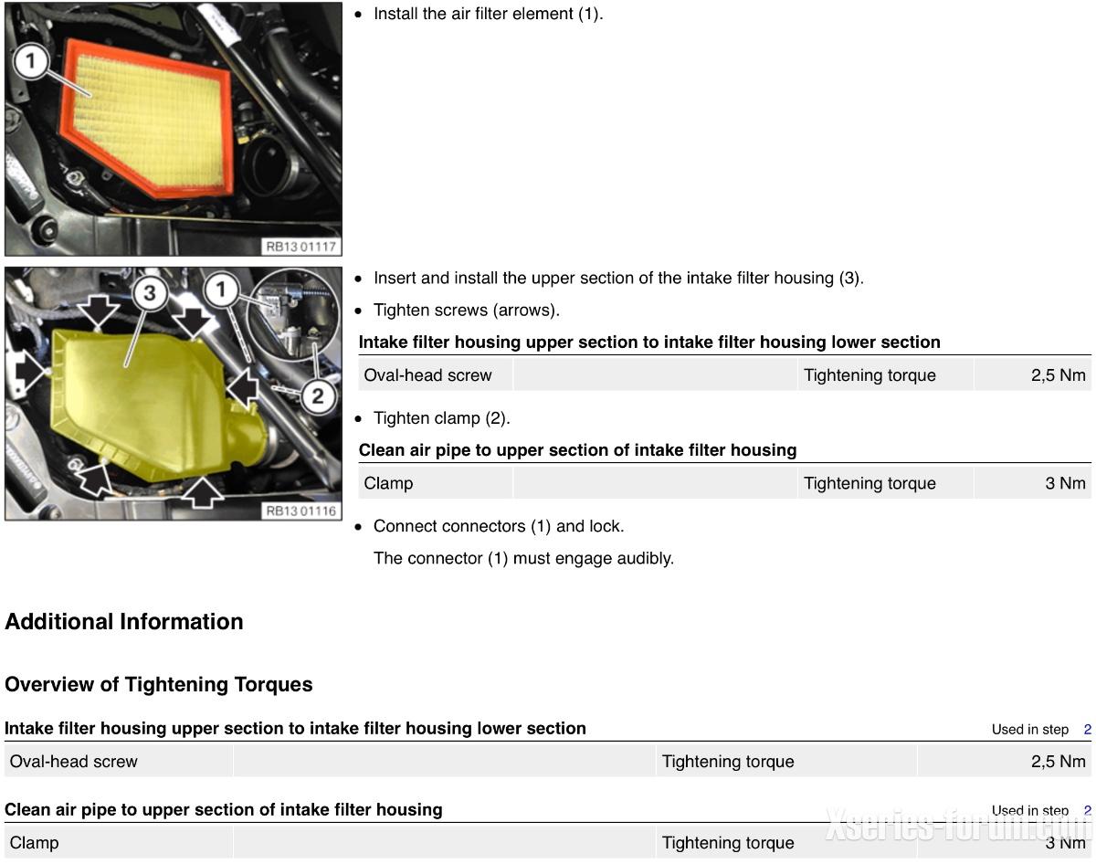

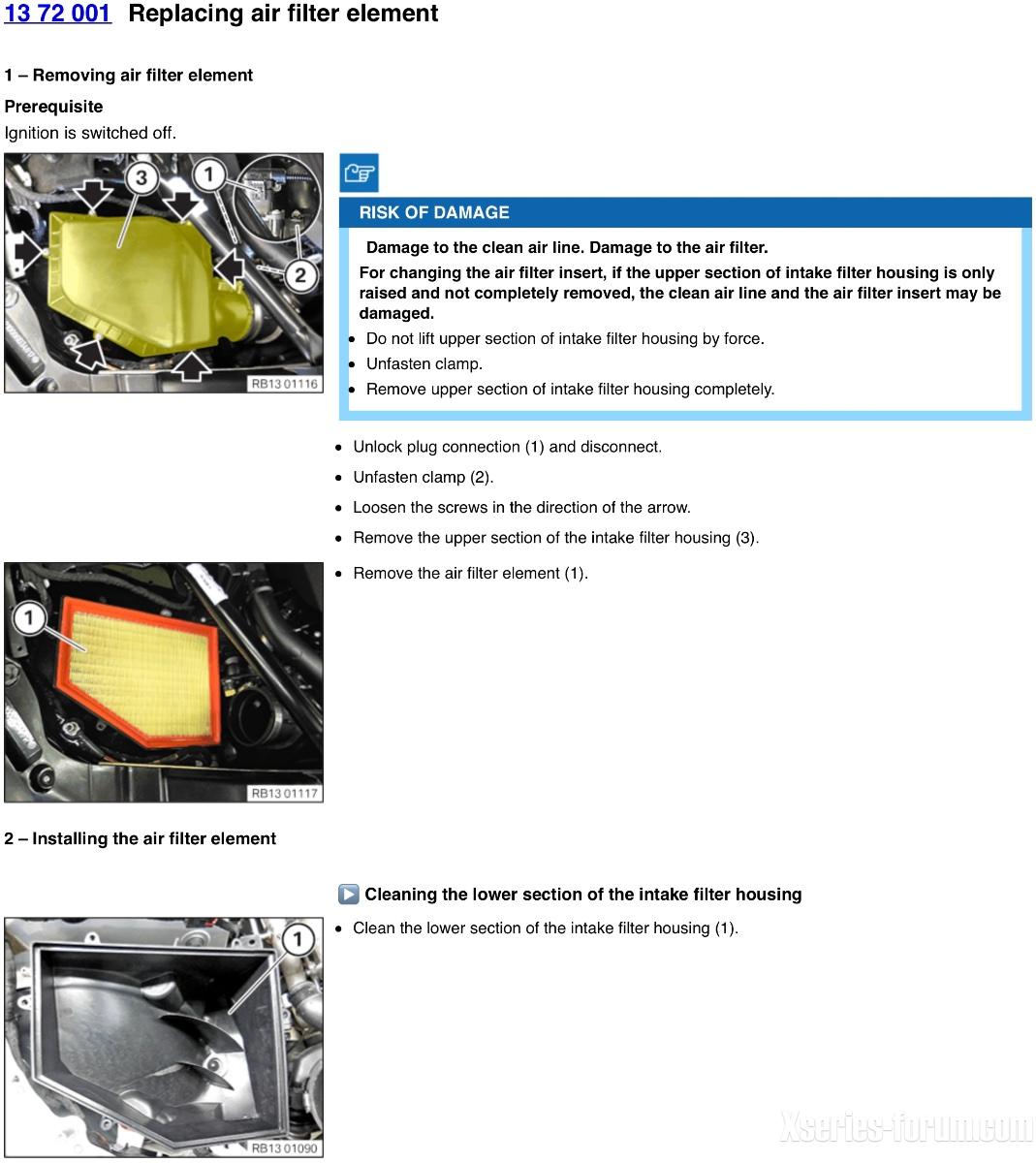

Which engine and variant? G01 ….? I’ve picked a 20i at random….these help?

No, this is the engine air filter as found in ‘Fuel preparation & supply’. The cabin filter is inside the vehicle (known as the micro filter) and located in the passenger side footwell. If you want the air filter that feeds the engine, mixes with fuel etc, then this is the one
You need to state which engine you have. These images are for the G01 20i, in production since 2017 (planned end 2024). ‘G01’ is the BMW production name for your X3. Most current models have ‘G’ prefix. Earlier ones were ‘E & F’ series. All current ICE powered X3’s are a variant of the G01, hence needing the engine size and fuel type. :)

It does, and the instructions above are exactly the same. :). This is for the engine air cleaner filter in the engine bay. As said the cabin filter is inside the car above the passenger side footwell.
