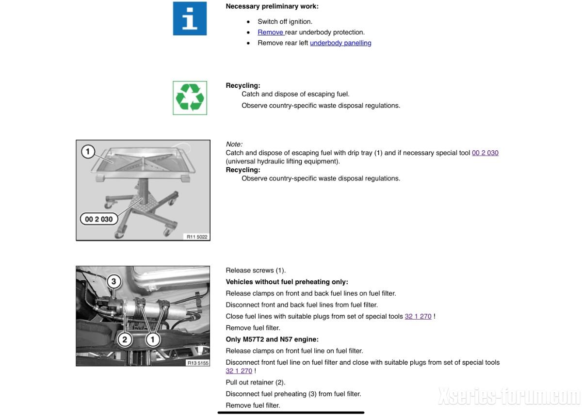

Would it be this part?
https://www.realoem.com/bmw/enUS/showpa ... Id=13_1230
Comes with a fuel strainer. I suppose I'd better get one just in case we get a freak winter.

Have a look underneath to be certain (or check with a dealer parts team - then order elsewhere to get it cheaper).
