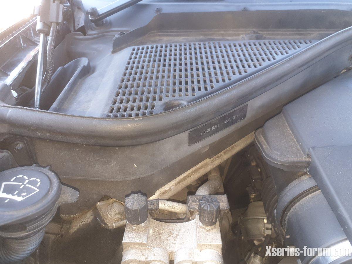

You are right about this there are water trays at the back of the engine and they split and drip water on injectors 5 and 6 , I looked at mine just this week and the drivers one is split and will be letting water in , until you touch them they look fine but they are just sitting there and wobble when touched .This in mine the piece with the build date on it , looks fine but its actually broken in 2 .The centre one is the most critical and they get brittle with age.marti wrote: Sat Mar 19, 2022 9:45 am Can you see any evidence of water ingress around at the rear of the engine around injector 5 & 6?
