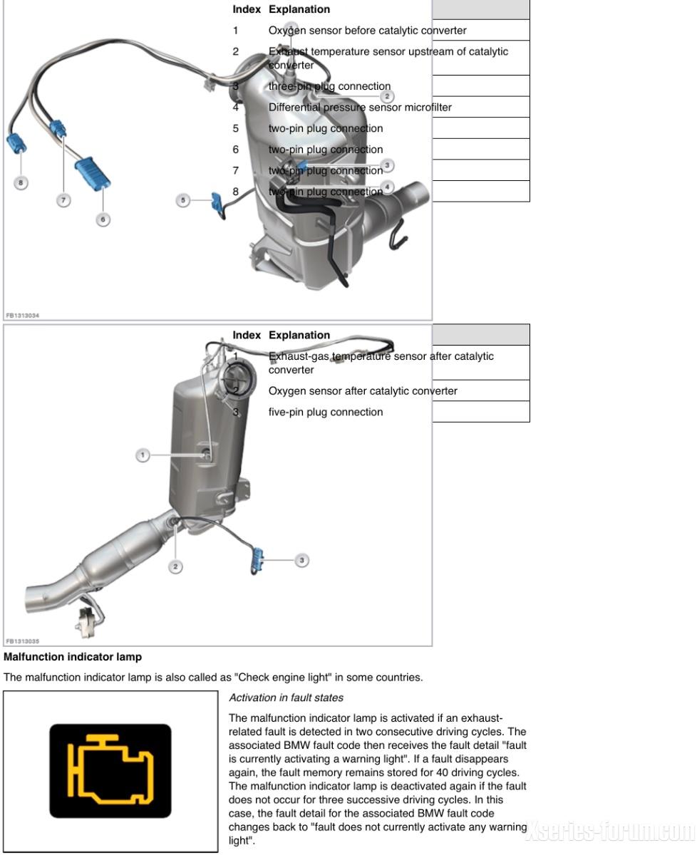

Does anybody know how difficult it is to replace the o2 sensor and exhaust temp sensor? Thanks
Posts: 19166
EGR Fault
Post by X5Sport » Fri Mar 18, 2022 10:12 am
There are two. One at the top of the Cat/DPF and one just behind it on the main exhaust outlet. Both appear to be a case of unscrewing and refitting. Item 1 in the top drawing and 2 in the lower.

Hi thanks for the information. If there is 2 o2 sensors do you know if the codes state which one is faulty. Thanks
Posts: 19166
EGR Fault
Post by X5Sport » Fri Mar 18, 2022 9:20 pm
The codes are supposed to say either ‘before’ or ‘after’ the catalyser (their term for the DPF/CAT), (2C2C (before) or 2C7F (after) might be the ones you are looking for). May need a non-generic code reader to pick that up though. I can’t find the actual codes for the E70 40d.

Code 49ef is a short to ground on an O2 sensor. Changing it requires coding action to reset the adaptions in the DDE memory.
Code 4986 is the exhaust gas temperature sensor before the DPF - the upper one is faulty, or the wiring to it is.
Code 4207 is an open circuit on the O2 heater line. Code 4206 also the same issue. Possible wiring issue.
Code 4258 is the DDE noting an issue on the O2 sensor diagnostics
Code 4590 - fuel rail pressure as above. Code 48F5 is the same.
Probably worth have a good look at the wiring to the O2 sensors themselves as there seems to be an electrical connection with all of these faults. The issue might be a damaged loom, dirty connectors etc.
