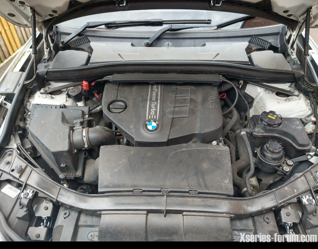

X5Sport wrote: Fri Feb 11, 2022 12:25 pm Some of the below may be partly duplicated across two images. If I get time I'll try to neaten it up a bit. It’s for the F48 2.0D
This procedure below is not for the DIY iliterate!! I'm not sure I've ever seen so much work being needed for a bl@@dy battery!!
Hey pal,thank you again as always, I saw some vids about this and the level of work to change the battery made me laugh out loud. BMW are selfish buggers just want you to come back to them no matter what. I know BM's have many engine variations, I cannot seem to see my specific engine layout. If you look at the picture uploaded mine is different , most notably the air box on the left hand side compared to the right.
You don't happen to have the battery replacement procedure for this engine (2015 2.0 diesel

That’s the only procedure I found, and it doesn’t state the year/variant, just the model and engine. Sorry.

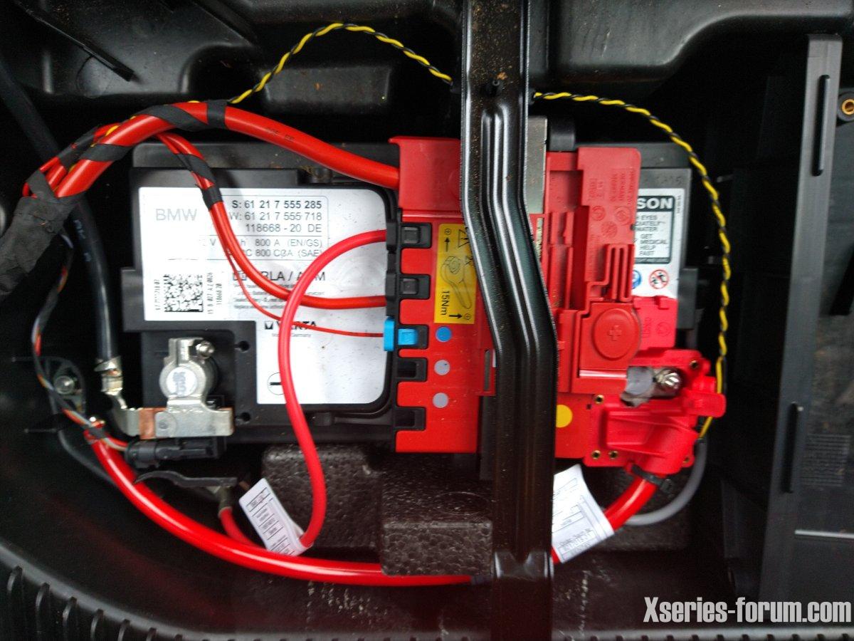

Not a worry, appreciate the help, seems I have lucked out and have the easier variation (in BMW standards) to replace the battery, in the boot version.X5Sport wrote: Sat Feb 12, 2022 8:38 am That’s the only procedure I found, and it doesn’t state the year/variant, just the model and engine. Sorry.![]()

That’s handy
Also annoying that isn’t mentioned anywhere in the guide I found. I’ll remove the images in a couple of days if they’re no use in the UK.
I’ve only ever seen one of the current BMW models with a battery up front, and that’s our 2-series Grand Tourer. With 7-seats there’s no space for a battery in the boot.
