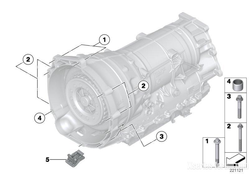

I've had a look around and a bit of googling and found out that there should be a cover that acts like a sound deadening plug but its listed as a vacuum cap. So back down BMW tomorrow to get one ordered. (Item 5)
I'm slightly concerned that the torque converted looked covered in rust but going to ask at BMW when i order the part if this is something to be concerned about.

A rusty TC isn’t anything to worry about as all the clever stuff goes on inside it. If it’s just the cover then that’s a simple and hopefully cheap result. Winter diesel does make a difference. My X6 is a little down at present (2-3mpg) and was noticeable on a run to Wales at Xmas (300 miles each way). As suggested, a Diesel engine takes much longer to warm up than its petrol brethren so will stay in ‘cold’ mode for longer too.
I wonder why the cover fell off? Just one of those things I suppose, or knocked during a service maybe and kept quiet!
