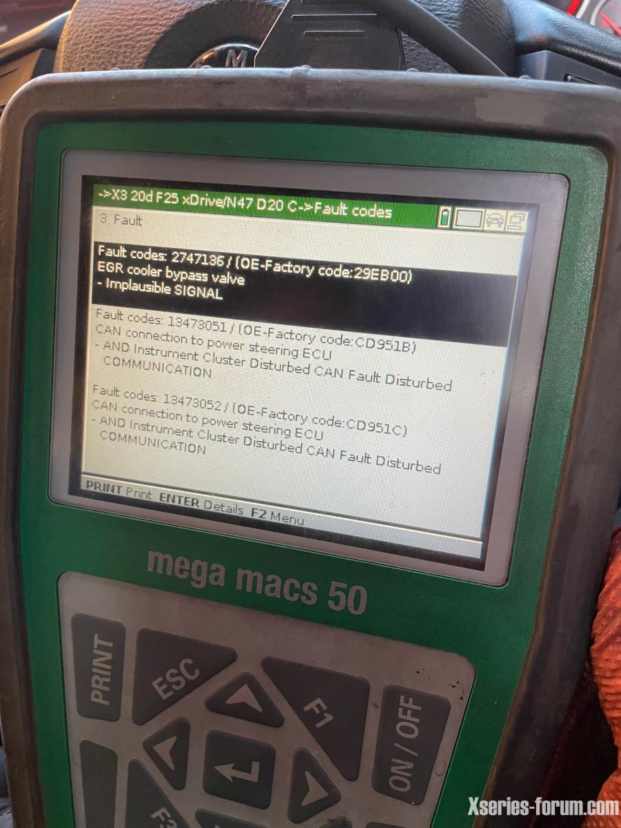

At the end of August 2021 I noticed two wearing noises on my beloved X3. I took the car to a local BMW specialist garage for a diagnosis.
A few days later I was advised the transfer box was on its way out and needed replacing. At this point my gut said sell the car but with the second hand car market being expensive at the moment I decided to go ahead with a refurbished box for £1200.
8 weeks later ( lack of boxes available I was told ) the transfer box was fit. On its test drive it was now noticed the front differential was wound up and left as is would damage the refurbished box. Cost £1300.
As I was already £1200 in I decided to have that changed also. Another 8 weeks later the differential is changed.
£2500 and 4 months later my car is ready for pick up. I have the car and drive 15 miles in it and I get a very brief warning light on the display and the steering went heavy. I pulled over and turned the car off. I started the car up again and no warnings and steering fine
I phoned the garage who said to take the car back to them to plug in and see if the fault had registered for that brief moment.
I was passing the garage my work use for there company vans, so I asked the garage to plug in and run a full scan of the vehicle. Please see photos attached. I’m total there were 17 faults codes. I found that surprising as the garage who carried out the repairs have all BMW software and they had advised me they had already carried out the checks on a test drive as they had to re program some software to set up the new differential.
I had the garage I was at clear the codes to see which ones came back, just to confirm it wasn’t a error with the car being stood.
I leave the car a work as I didn’t feel it would get me home and to prevent further damage.
The next day I start the car and drive around for 10 minutes as I get back to work the car brings up two fault on the display please see attached photos. The power steering stops working.
I call the garage who did the work and advise them the RAC will be bringing the car back to them. ( really not happy )
The RAC patrol man checks over the car and confirms it’s power steering related, I asked him to check the battery to endures it charging, which he did and confirmed the battery was charging correctly. 14amps I believe he said.
Car taken to garage who advise the steering rack is faulty. The electrics are drawing the battery down. It’s needs a new rack or refurbished. Still waiting for a cost.
When the car went in back in august there where no faults with the steering. Can someone confirm if to access the front differential the steering rack would have been taken off.
I feel something is not right and I’m being taken as a fool.

Steering work is not part of the repairs for replacement of either the transfer box or front differential. The official instruction make no mention of doing anything with the steering. All the work is around the driveshafts and that’s all. No work on steering parts at all.
Changing the transfer box with another unit rather than the one fitted may require coding work. Was that done?
Have you had a full wheel alignment done at all? Is the steering wheel position correct for straight ahead - I.e. the wheel is centred properly?
If however the steering was moved whilst the repairs were conducted then the system possibly needs recalibrating so that the systems know where the steering is actually sitting (I.e. straight and centred). This is needed so the DSC etc knows where ‘dead ahead’ is as far as the steering angle sensors are concerned. That detail forms part of the input for the stability system so it knows what the steering is doing at that moment.
Has the instrument binnacle been out at all? Has the steering wheel been removed at all? If yes then the system needs reinitialising. A lot of these errors are electrical not mechanical.

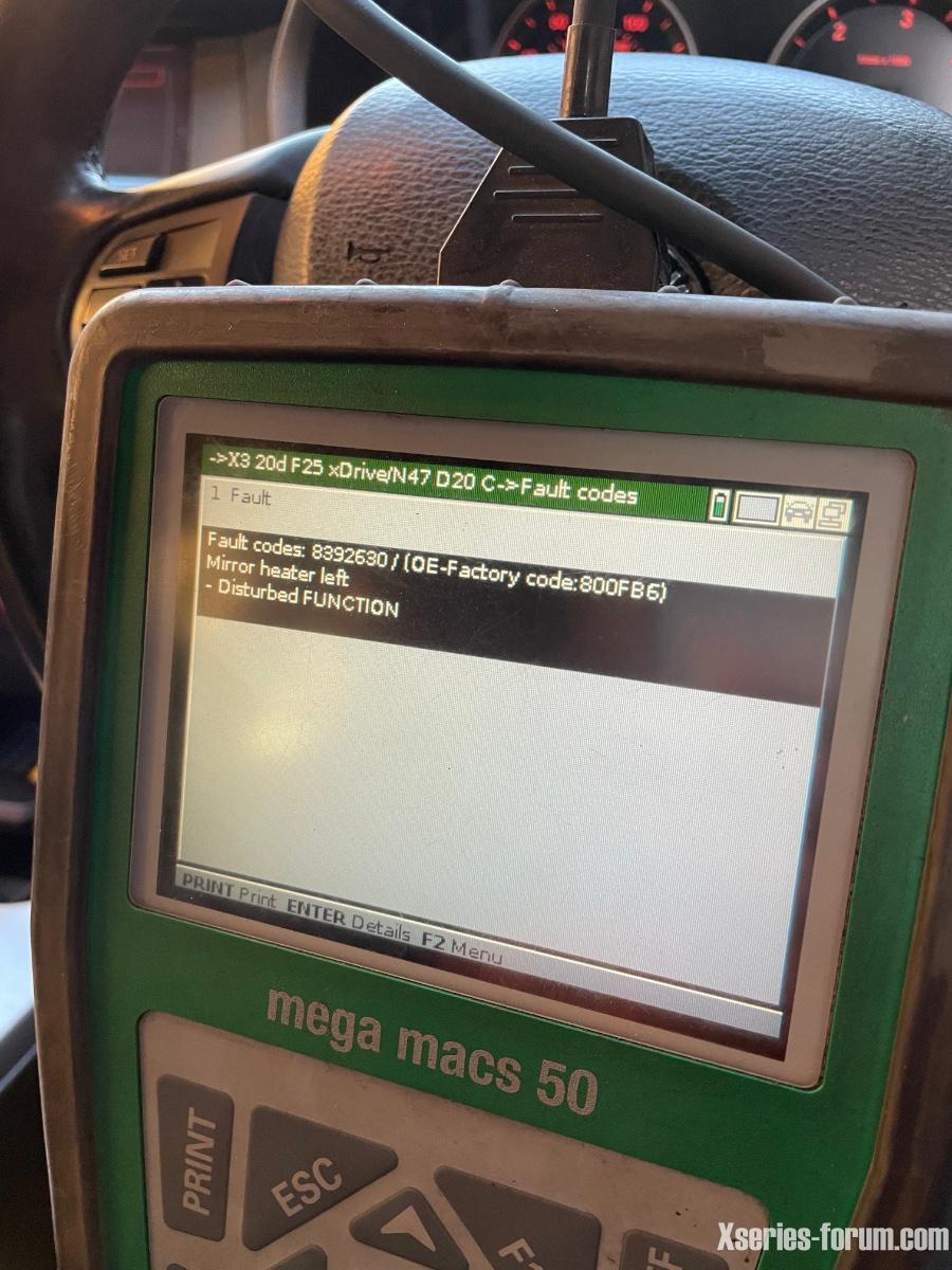

NOTE: You might also be chasing a ghost. The tyre pressure monitoring (TPM) system isn’t happy and that can trigger other faults all connected with the DSC and steering. Do you have sensors in each wheel and are they all working? I lost a TPM sensor in my F46 and various errors showed up. The TPM sensor in one wheel was broken. Once replaced everything was fine again.
Your car is also reporting under voltage. Is the battery OK? It must show at least 12.6V DC with the engine off, car ‘asleep’ and after 4 hours since last used. Anything less than that and your battery is dying, regardless of whether the alternator is charging it or not. Before you go too deep make sure that your battery is OK. Changing the battery requires coding as well, you can’t just swap it over. Measure the voltage from under the bonnet. It’s best if you open the bonnet a bit, lock the car and come back 30 mins later, then check it.

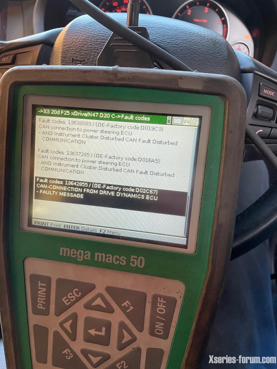

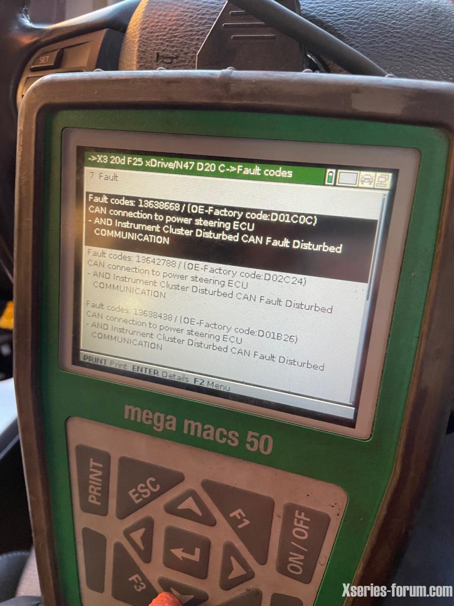

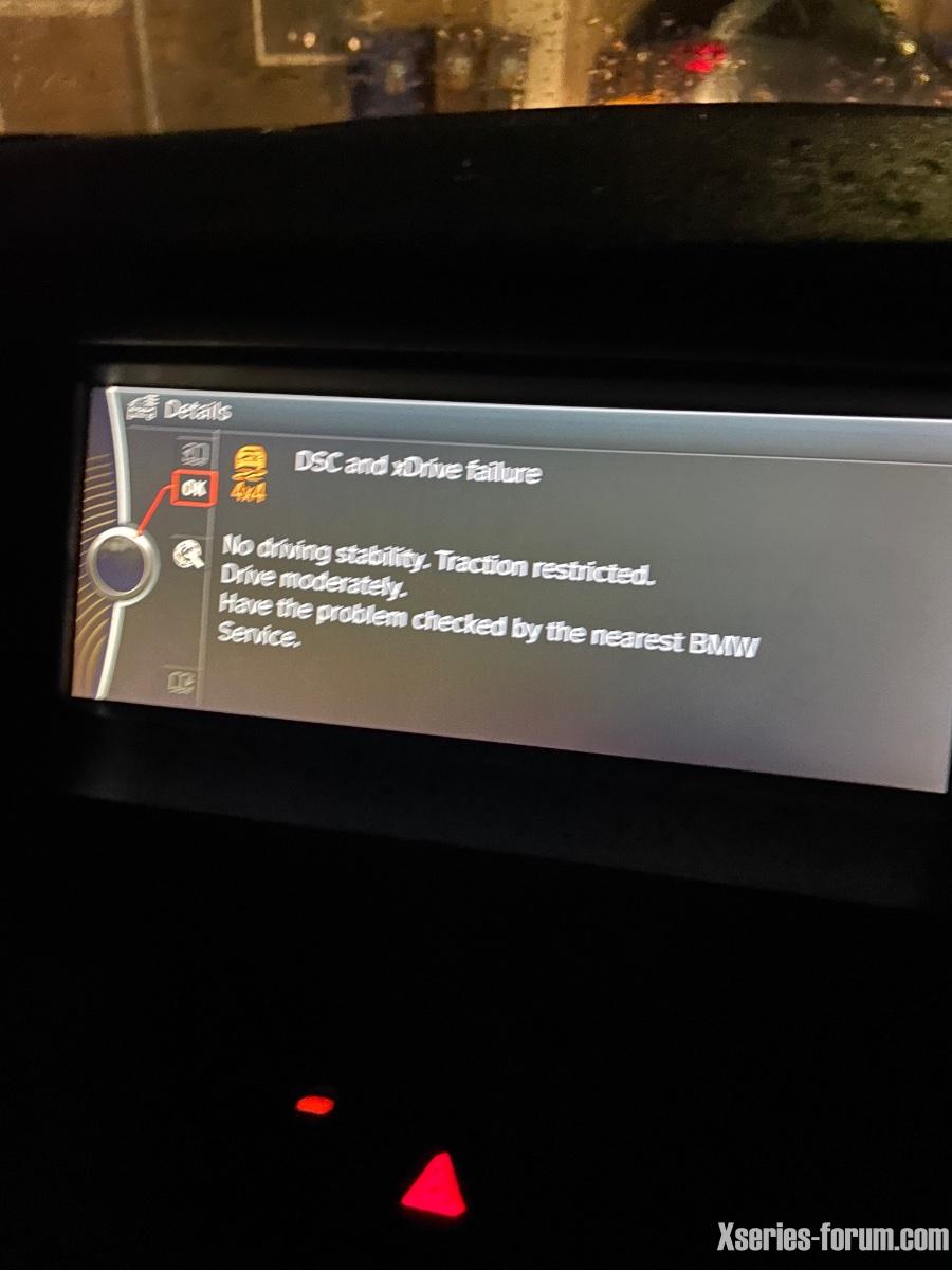

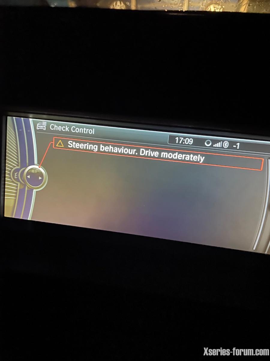

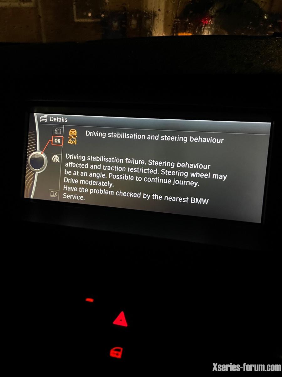

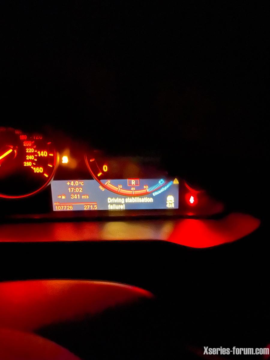

Yes the steering failed the first time as I turned but came back on after I turned off the ignition and the back on again.
The second time it failed when I had the vehicle retuned I was turning again. This time all errors in the display came up.
As a point the pictures showing fault codes was before the car displayed all on the dash of that makes sense.
The garage have just said the electric power steering is drawing to much current and can’t be repaired. It’s a full rack new or reconditioned.

If it’s the EPS (electromechanical power steering) control module then that is built into the rack and may be why they are saying it’s a full replacement only.
Checking the battery voltages will tell you if the battery is the issue. If it’s more than 5-6 years old then it will be approaching its end of life, but a meter check will tell you for far less than a new battery!
Good news about the tyres, but that does raise a question about how/why both the front diff and ATC450 unit failed.
If it were me, I’d actually seriously consider letting BMW run a diagnostic check. It might cost you a bit, but their software could help identify an issue that saves you big bucks.
A new EPS rack retails at well over £2k, hence suggesting a second opinion is sought. It might be damaged wiring rather than the unit itself, especially as work has been done in that area? It’s close to the front diff.
