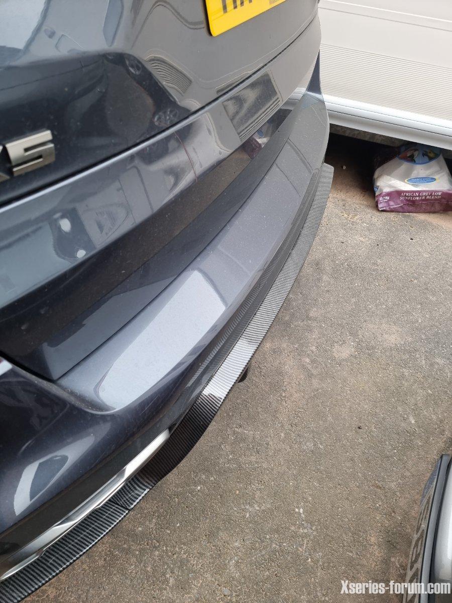

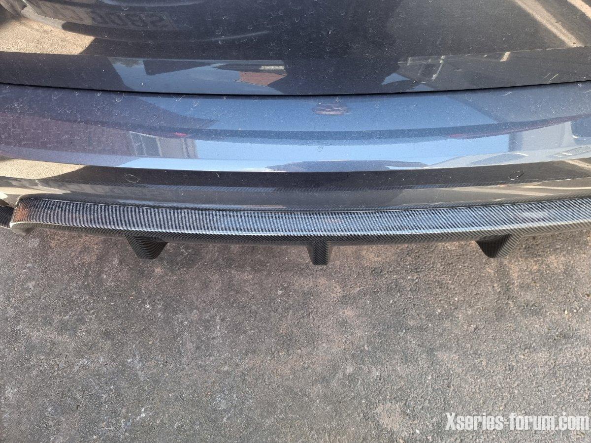

Looking to fit a detachable bar to my X5, as need to be able to tow the caravan with it.
However, I'm wondering if having the CF rear splitter thingy will affect it?
Have spoken to BMW who confirmed that theirs (Westfalia) doesn't state that it's "not" compatible with the bodykit, so they say it will fit - However, at £1800+vat for the parts alone, I think I'll be sourcing my own!!
Just worried that the ball will be too close the the CF to allow the caravan hitch to fit properly, pic below..

Have a look at PF Jones website as it will list the options. The BMW cost is because most of the interior needs to come out to run the wiring. Westphalia bars are very good and I’ve bought kits through PF Jones and then diy’d the job. You can see all of the fitting (and body shell cutting) instruction on their website. You will need to make sure you buy the specific BMW wiring kit. Overall you’ll probably save £1,000 by not going to your dealership.
What you may need to watch for is the gap between the splitter and towball meets the minimum clearance limit.
PF Jones will also give you advice by phone if you need it. Some models need a specific rear bumper as it includes a removable panel to cover the towball hole when not fitted. They list a G05 version at just over £300 and a specific wiring kit (13-pin) at just over £140. That’s a lot better than BMW for the same hardware. You should fit 13-pin electrics these days.

Update on this.. The towbar would work fine with a "normal" hitch, but not with the Alko anti snake fitted to our caravan, as it's about 30mm closer to the car than a "plain" hitch.
No biggie, carbon trim comes off with 4 screws and have replaced the 2 "bonded" areas with HD velcro. Works a treat and takes 5 mins to remove/refit.
