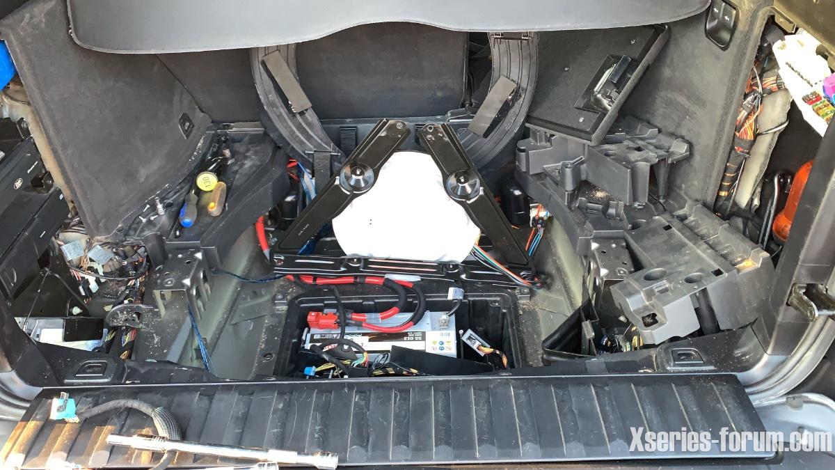

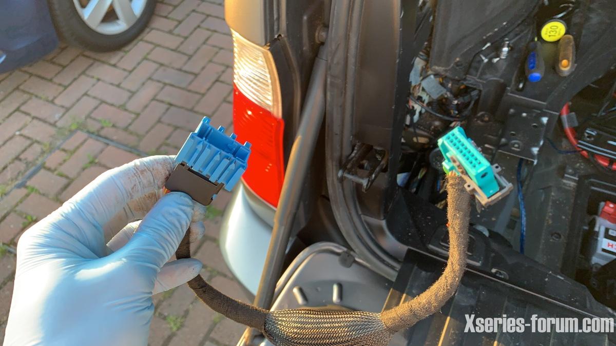

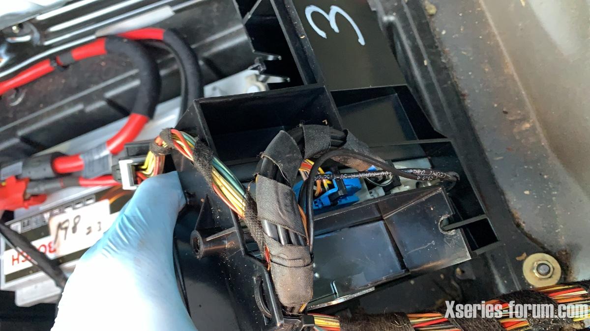

Just a wee update… pulled the car to bits today & had a deeper look into the audio system. Removed an unknown adaptor from a rather large module with a cooling fan in the boot. After it was removed everything returned to normal. Everything works perfectly. Even the steering wheel controls have sprung into life. Put the strange adaptor back in & everything continued to work perfectly.
So yes the problem is fixed but unfortunately I can’t describe how I’ve done it

Well i have no idea what that connector block is either
curious how it reactivated missing things when removed but didnt recreate a problem when re-fitted.
