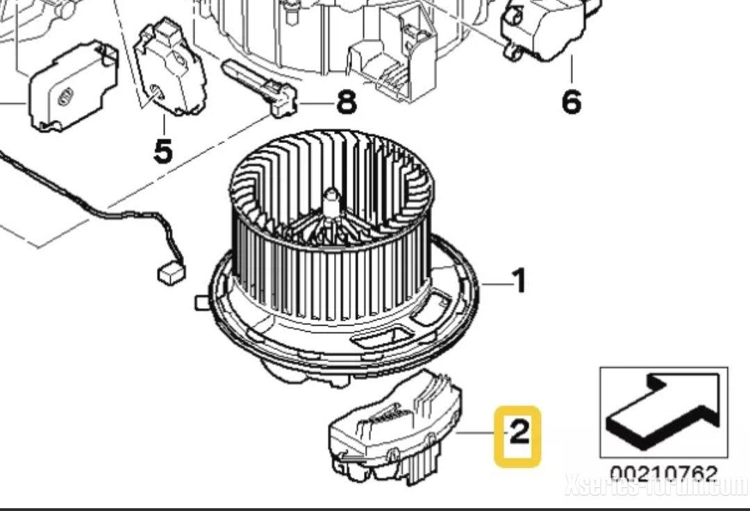

No reference to such a beastie on the E70, or in the AC parts list. There is a blower controller mounted on the rear of the blower though. Access means taking the glovebox & DVD player (if fitted) out.
Also worth checking the fuses as there are 6 listed for the climate fans!

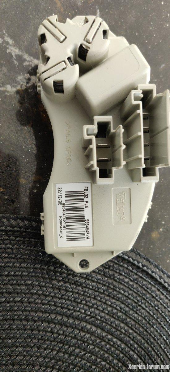

Post by pcdee » Wed Aug 04, 2021 6:18 am
Thanks for the advice guys, it was the blower regulator. It's behind the glove box and attached to the blower. Took about 45mins with lots of F & C words.
It's awkward to take out and put back in and if you got back problems I'd stay clear.
I've attached the part in question for future references should anyone need one.
