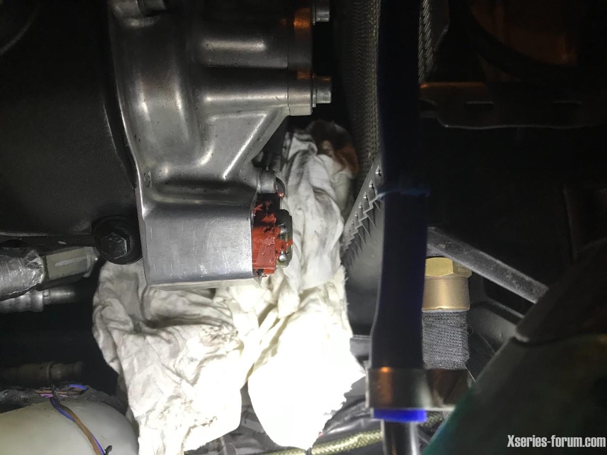

Going back on track about the vanos I’ve been thinking...
Obviously I want the noise to go away at minimal expense so I’m going to remove the vanos solenoids to give them a really good clean out followed by changing the oil and filter to see if it makes a difference. The thinking behind cleaning the solenoids is that maybe they are a bit gummed up and not allowing full oil pressure? Just throwing it out there as you never know.
As for the oil - I’m sure the engine wasn’t as loud before I changed the oil last year. It had shell helix in it. I may try a liquimoly flush too.
Thoughts..
Thoughts..

M62tu 'diesel knock'
You never know what you will find when you start fiddling. This was BMWs solution to stop the solenoids leaking out of the covers. It didn’t stop the "o" rings from busting and causing the cam timing to be wonky
What on earth is that mess..
