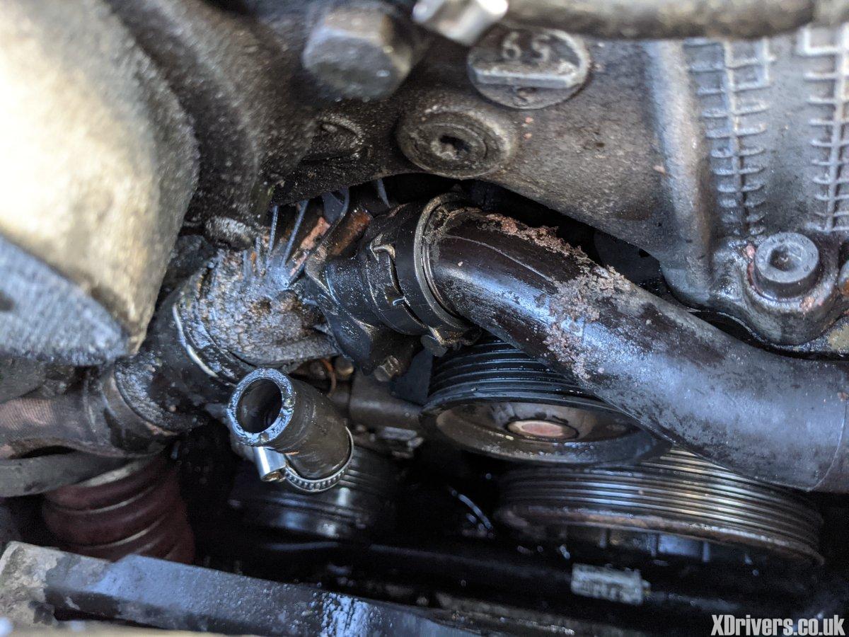

The plot thickens with the root cause of this issue...
Cracked EGR Thermostat flange cause of my initial coolant leak, appears to have written off my Water Pump and belt!
Under the covers is a wright mess created by this leak!
- Posts: 1529
Re: X5 E70 3.0d - Front Belt Failure
Heavy handed with a spanner over tight = crack.
You must have been losing water for some time ?.

i had the same "root cause" issue though any further damage wasnt done as leak was a bit more and made car to report temperature is too high, so checked and replaced EGR coolant valve. looks like its common fault or life of these valves snapping at exactly same spot.
thermostat, water pump and belts were also ordered as preventive measure, will do when get some time.
