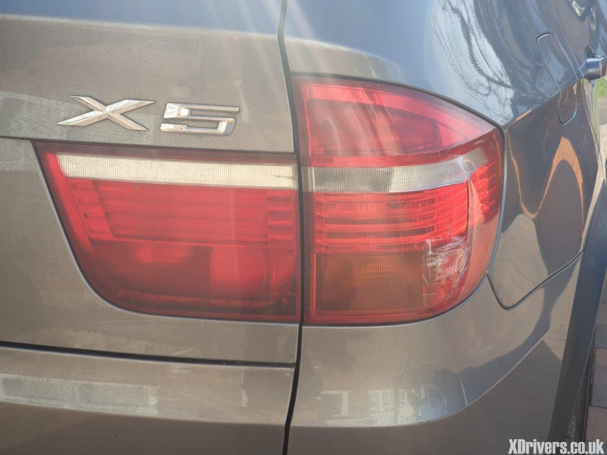

Hi All,
My ageing E70 has suffered somewhat in the rear tail light area. Both inner lights have water ingress causing some discolouration, and the RHS wing light just got broken by a cyclist when I was in stationary traffic. He kindly paid for the cost of an aftermarket replacement, but it got me thinking about changing the look of the rear, as I now need to change 3 out of the 4 lights. I had a look on eBay and found various sellers of a smoked LED bar type light which looks more like the facelifted version of the E70's lights. I actually like the look of these, and I think will look good on my grey X5.

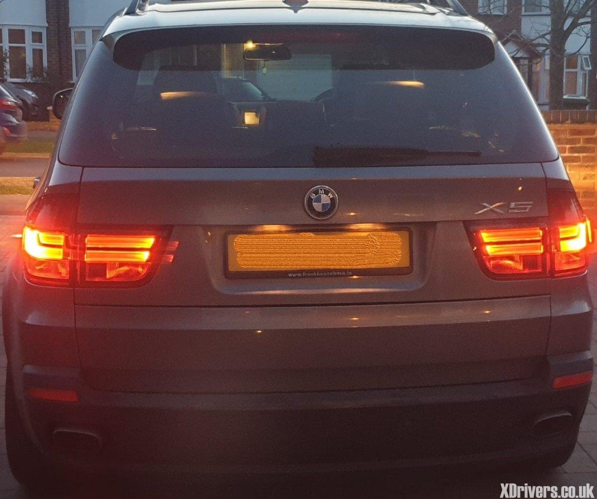

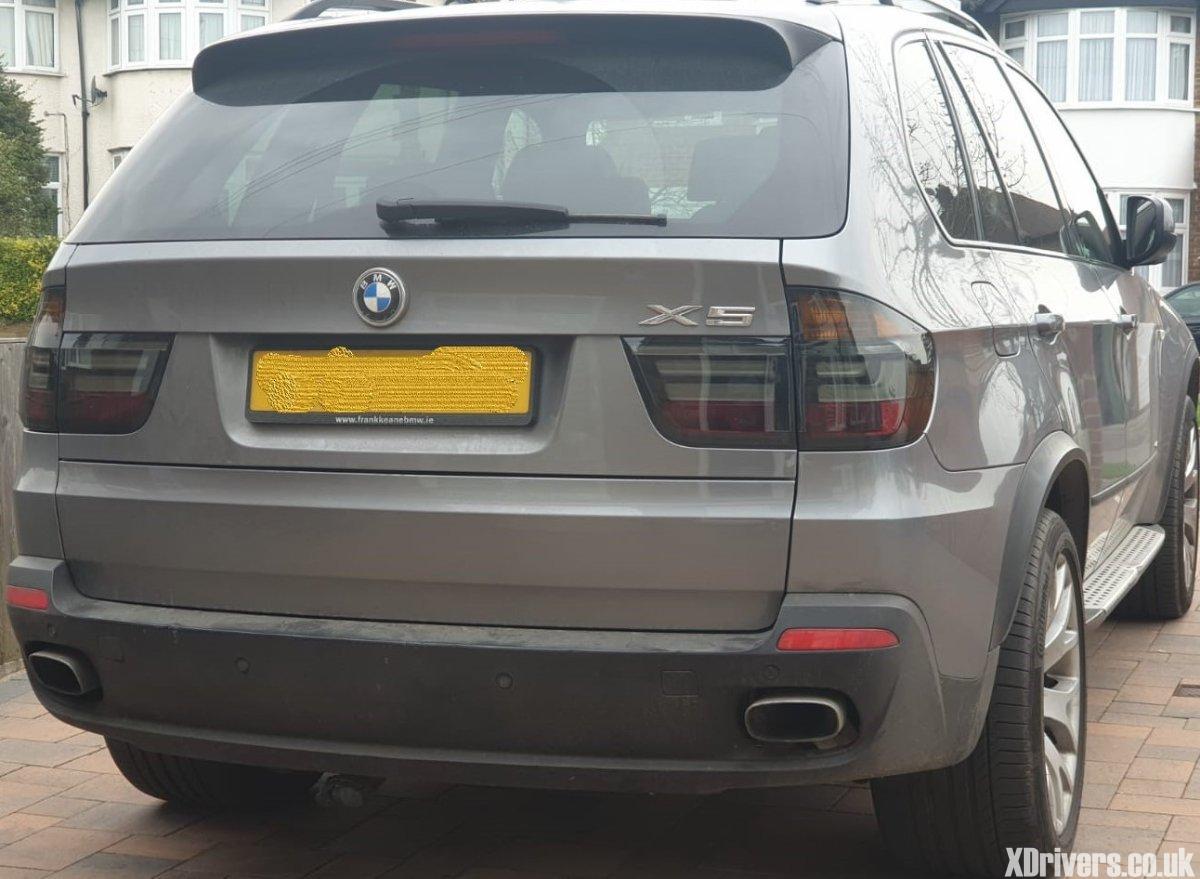

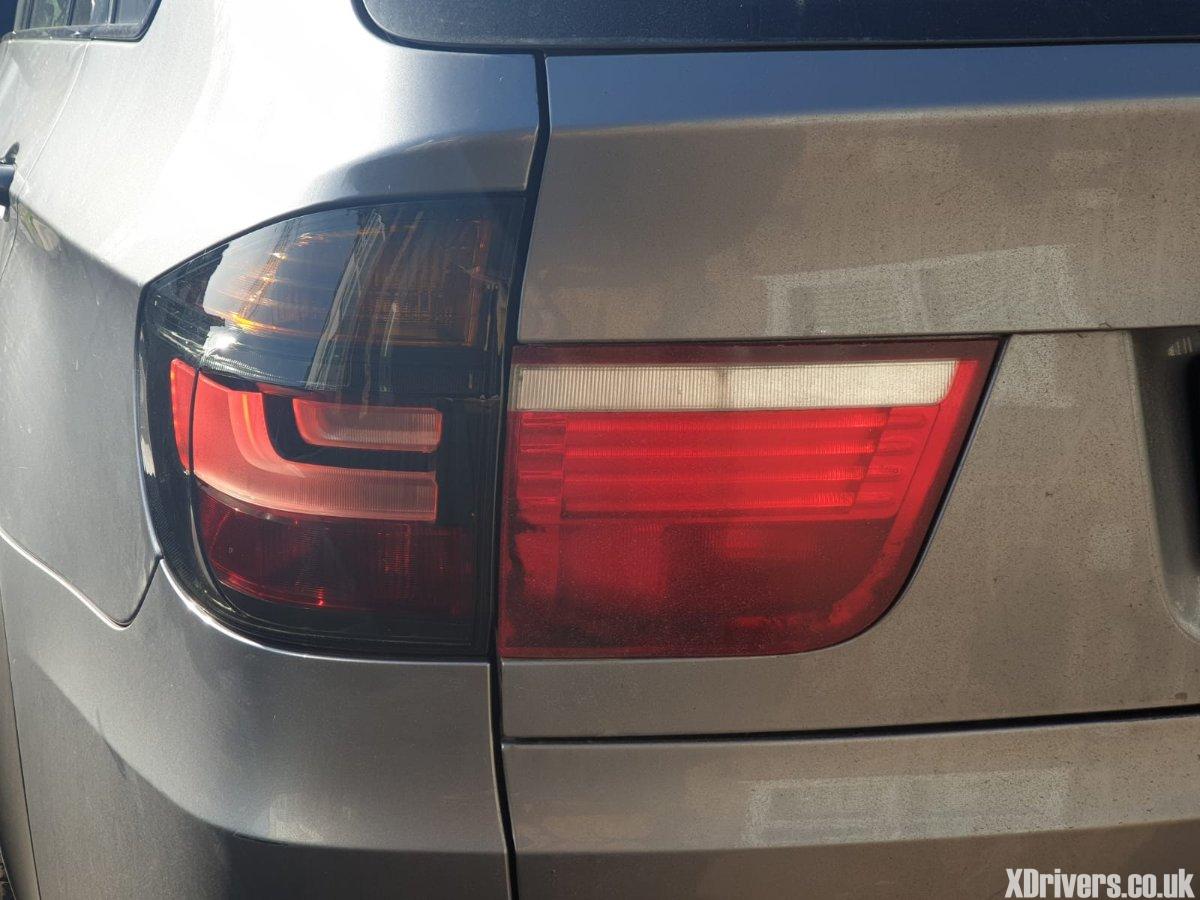

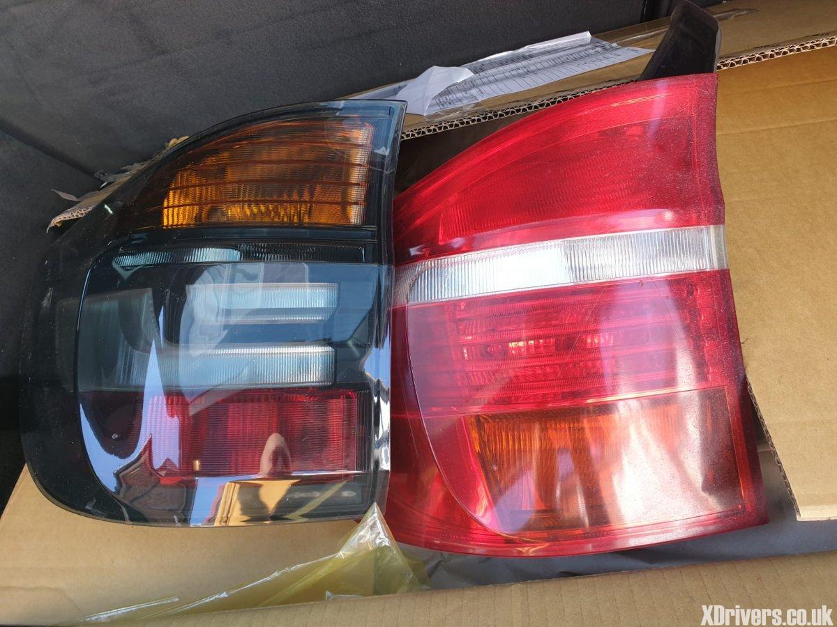

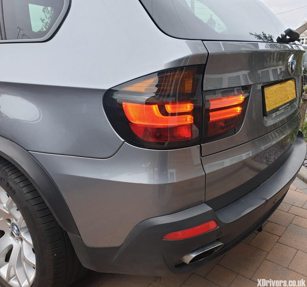

Hi All,
Well the lights took longer than expected to arrive. It was a UK seller, but they actually came from Poland. While it was taking some time to get here, I asked the seller about them, and they assured me I wouldn't get hit with any import duty.
Here are the results, hope the pictures come through!

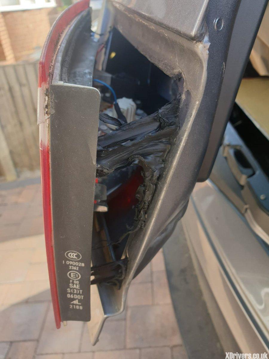

Overall the quality for what they are (aftermarket) was about 90% satisfactory, and I'm quite picky. Only reservation is the lamp mount on the back of the lights look a little flimsy. A resistor is provided in-line to the connector, as the units don't have a secondary brake light. The units come with rubber foam gaskets which are good. Fitting them are straightforward after a good cleanup of the old butyl sealant. Isopropyl alcohol worked good for this.
I did have the right indicator fail on me. Wiggled the cable and it's been fine since, so let's see how long it lasts before I need to check the connectors again.
All other lights work, including both foglights. I don't see it being an issue passing the MOT, as they are all bright enough, despite the kind of smoked look to it. Seem brighter than the originals, although mine were weathered!
Cheers!
