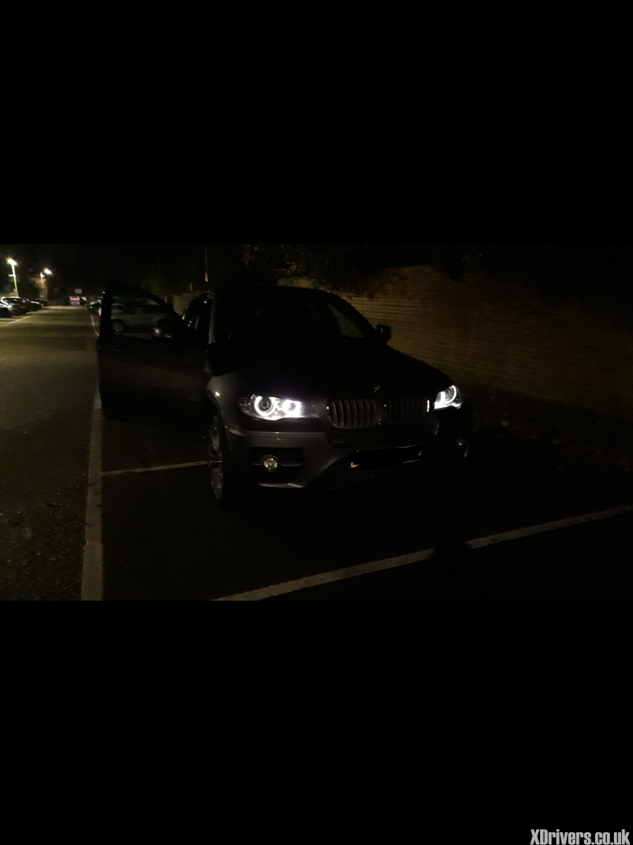

IIRC these are MTec brand, regular bulbs which are white but no regular bulb will get near the LED output of later models with factory LED systems.
My car with side lights on.

I know the photo is taken in the dark but these look pretty decent. What are they like in daylight out of interest?sapphireblack wrote: Mon Jan 04, 2021 12:14 pm Try hids-direct.co.uk
I'll take a look on there website and see what they have.

They are still white in daylight but not like LEDs. With DRLs selected on the car, dipped beam is on anyway, but at least everything is white with Xenons.Max5 wrote: Mon Jan 04, 2021 1:49 pmI know the photo is taken in the dark but these look pretty decent. What are they like in daylight out of interest?sapphireblack wrote: Mon Jan 04, 2021 12:14 pm Try hids-direct.co.uk
Does the linked website not work?
