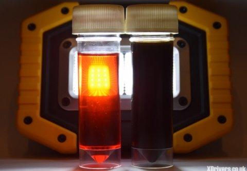

Thank you very much for the welcome and your advice. I think that the tyres are Michelin. what's correct? I always had Pirelli scorpion zero on the Discovery as that was the manufactures suggestion (and I have a friend who works for Pirelli and can arrange a discount) I am very keen to keep cars original and not scared of spending properly on preventative maintenance. The discovery has a terrible reputation but if you keep on top of things they are a very reliable car. I just fancy something different.
I believe that this model has the metal sump and separate filter so it is less expensive to replace the ATF? I assume that the torque convertor should also be drained and refilled? I did this recently on my C class Mercedes which is also 'sealed for life' See the before and after picture below. That's what 100k does to ATF. I think its all the proof anyone would need.

Pleasure.
Yuck!
The ‘standard’ tyres were Michelin Diamaris. Most of the Premium brands will have an offering so Dunlop, Bridgestone, Conti, Pirelli etc. Not sure if Diamaris are still available, but there’ll be an alternative.
Also useful to have a look at Realoem as it’s a copy of the current BMW parts database on line. If you can get the last 7 of the VIN you can pull up the right version of the E53.
You can DIY the gearbox oil and there is a specific procedure to do it. Videos on line will help. Yes the sump and filter come off and replacement kits are easy to source. You should change the bolts too. The box is a ZF GA6HP if that’s of use.

Thanks again. When I said "I changed the ATF" I should have said that my excellent specialist actually did the job. I just provided the sample bottles!
