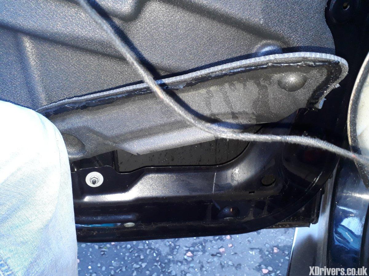

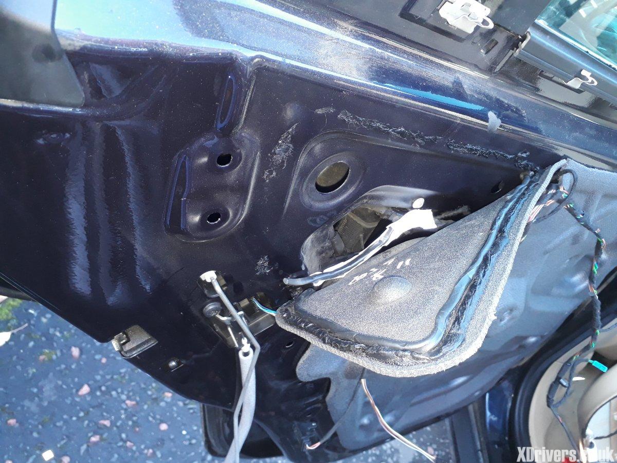

Got this done today , did both rear doors and both foam membranes had separated at top and bottom and you could see water marks on the foam at the bottom where it was running down ( heavy rain last night ). I have resealed with butyl tape so we shall see how it goes .

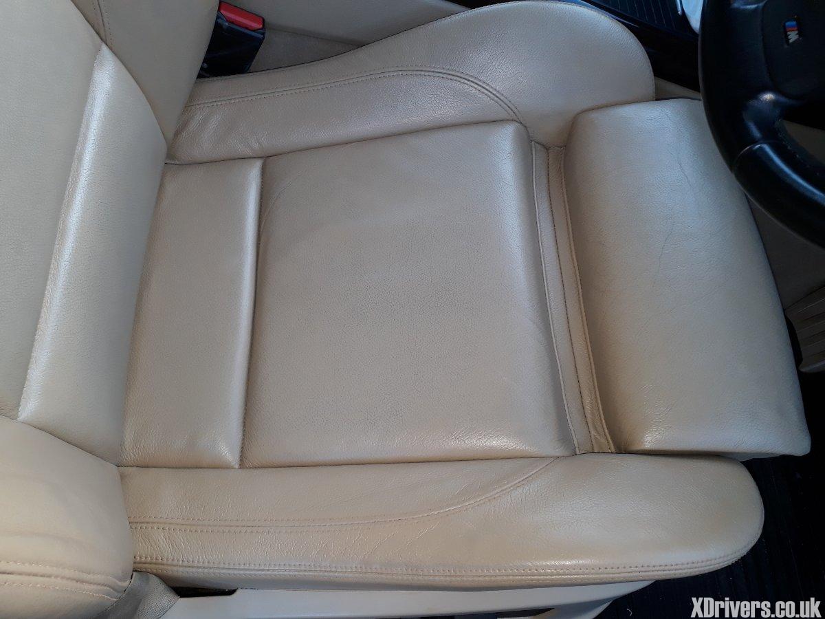

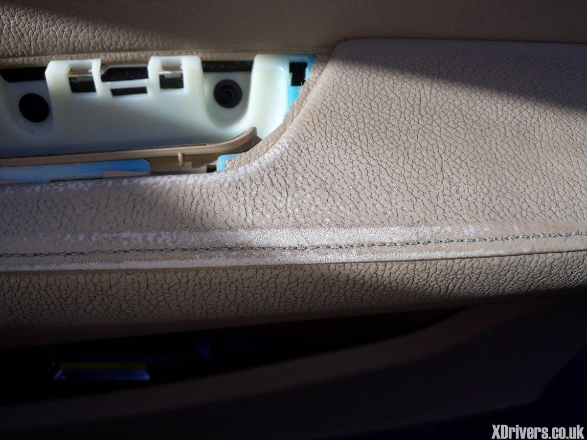

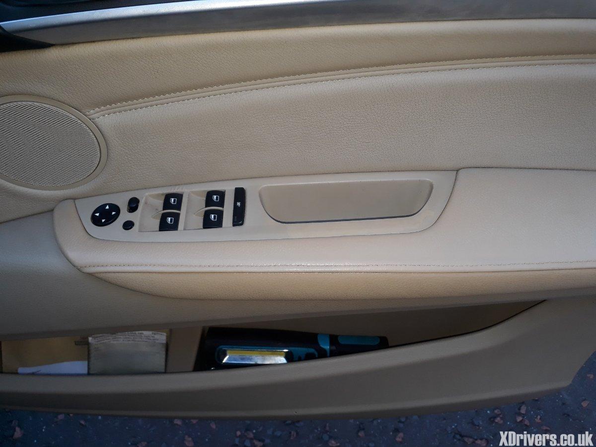

After that I got carried away and redyed the doorcard armrest on drivers door and the bolsters on the drivers seat then went whole hog and dyed the complete seat :lol: The colour match is decent but wher parts had wore through to the bare leather the dye didn't really want to take till I started daubing it on a bit heavier , looks a lot better now and you could probably do all 4 seats with the little kit from colourlock , not the cheapest but seems good so far anyway. Has improved the look of the parts no end and the rest of my interior is mint anyway as I'm usually the only passenger.

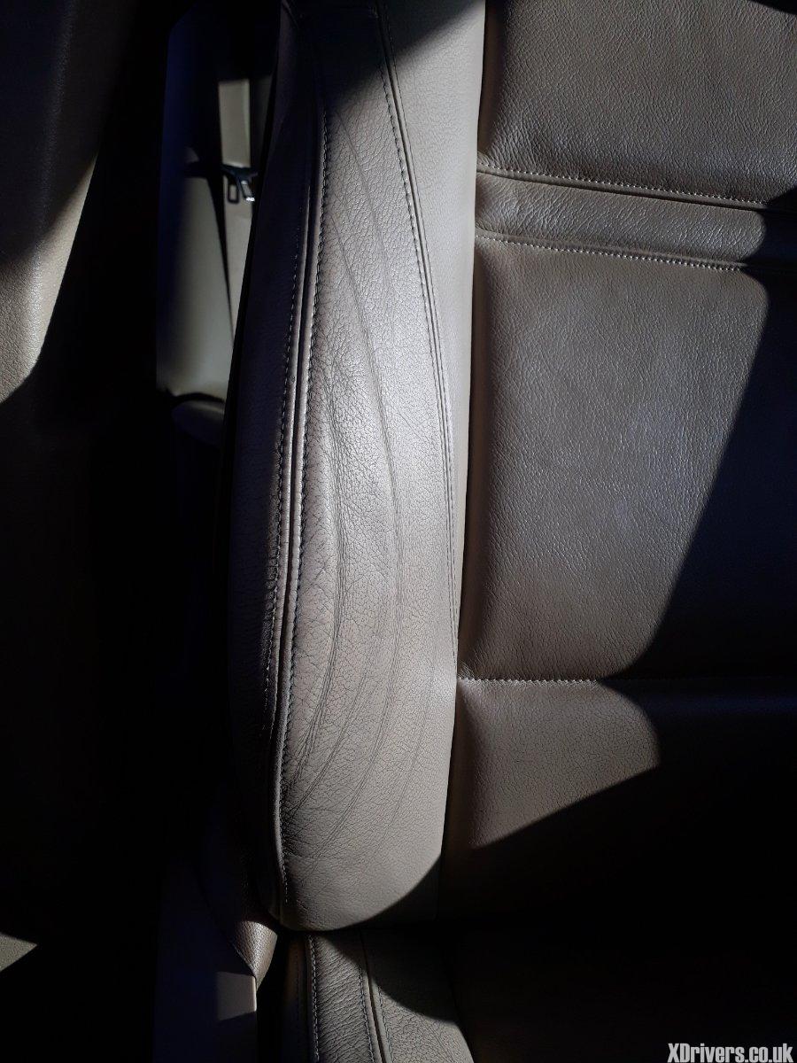

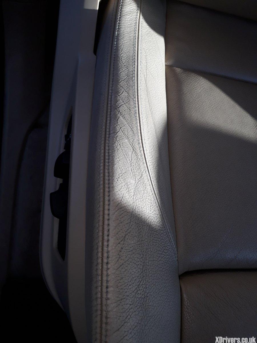

After a sand and a bit of dye , pics before don't show shoulder bolster was down to bare leather near stitching, this was hard to cover again.Could do with a new mirror switch beige panel as the rubber coating has come off but the genuine ones are about 50 quid and the Chinese ones down have a hole for autofold . The rubber paint would probably work out more expensive than a new plastic ! I will buy a cheap Chinese passenger door handle back though as mine is all sticky the way they always go , for a tenner its worth a punt ...... :driving:

Post by henrym3 » Sat Oct 24, 2020 7:36 pm
You’ve done a cracking job there Leslie. That leather looks well good. Hopefully you have sorted the water ingress as well.

Nice jobs there. Definitely looks like the butyl should do the trick after seeing the pics.
Leather looks much better.

Took door card off this evening and found about a 6-inch pet at the bottom wasn’t sealed. Ordered new butyl roll and will get it sorted. Thanks again pal
