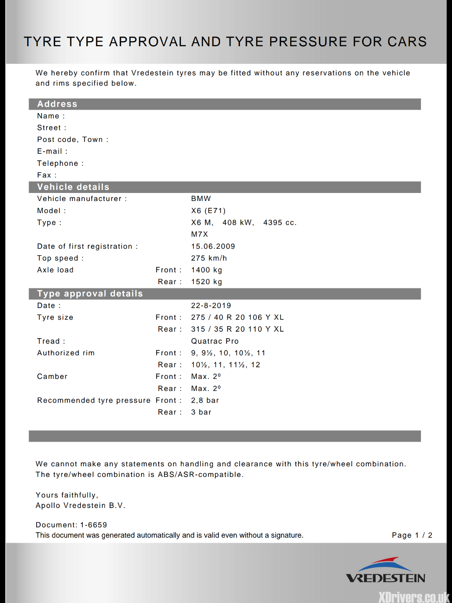

As an aside i still have an unused wheel set with Pirelli * winters on them but thoughts have turned again to all weather options, albeit none afaik are runflat. I emailed Vredestein a while ago who confirmed they are happy with their staggered size Quatrac on BMWs fragile transmission. Of course if the tranny had a hissy-fit i doubt they would pick up the bill.

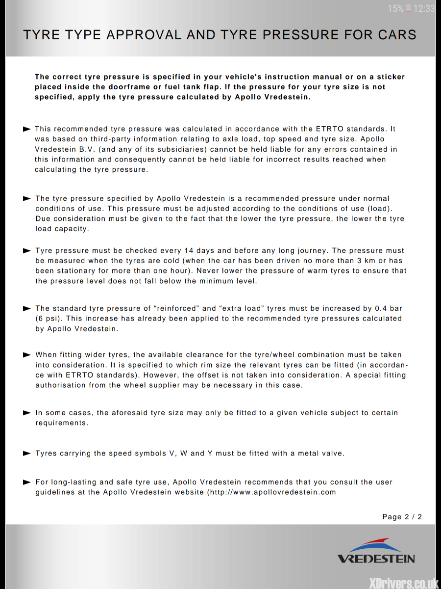

I'm interested in those tyre pressures 2.8 bar front and 3 bar rear , a lot more than quoted for runflats !

Leslie wrote: Thu Oct 01, 2020 8:15 pm I'm interested in those tyre pressures 2.8 bar front and 3 bar rear , a lot more than quoted for runflats !![]()
If i had posted page two it would be useful
