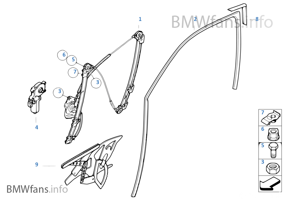

Re: Rear door glass o/s
Item 1 has broken parts
Well the regulator doesn’t look like that but the plastic part on the runner where the cables meet has snapped in half.
Strange as the rear windows are very rarely used. I’ve just bought a whole new regulator including motor new for £29.99. Gives me something to do in a few days..
