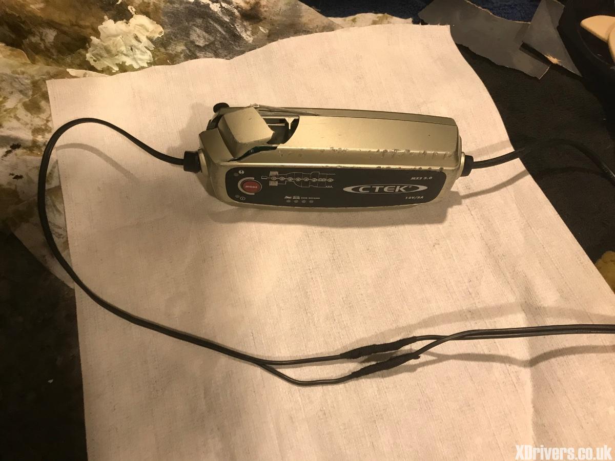

My battery life has recently taken a nose dive, mainly due to the fact that I drove over the charger. It’s in the corner of the garage looking like 2 ton just drove over it.
- henrym3
- Posts: 1990
- Location: Bournemouth
Re: Battery life How long to discharge
Let’s ignore the stupidity of driving over the CTEK and instead give some praise to the CTEK, it still works
