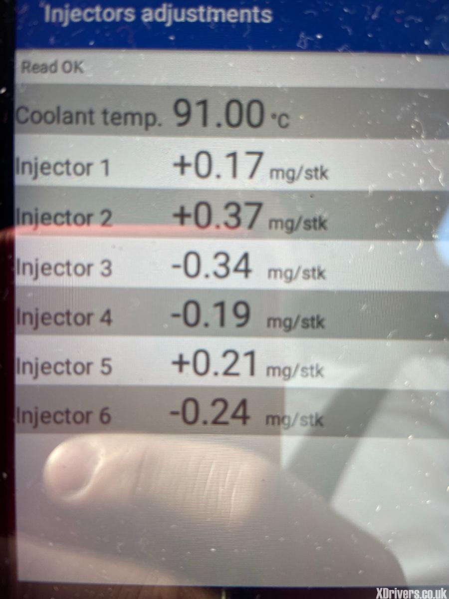

So have done a tank of fuel with additive as suggested, engine does seem quieter, injector values have changed, both readings I took after same 40min journey, figures seem closer together, having read specs for the injectors they can be either -/+.5
So from previous reading it looks like injector 2 was just over spec, but is now within spec, however I am sure these readings are affected by air temp, engine temp etc, so I am sure if I took them even every hour they would vary widely.
Engine seeming noisier could be down to the lack of additives in the supermarket fuel as discussed and just what i believed the engine to normally sound like.
I will be filling up the tank again to the brim, but will be getting it from Tesco and seeing if the engine once again seems to get noisier. Then I shall add the 2 ethyl hexyl nitrate.
