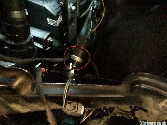

We had that sensor (or its equivalent) fail on the E46 and I was very surprised at just how expensive they are!

If it was a guaranteed fix I’d probably buy new so I’d rather try the £5 jobbie first even though I’m aware that it’s only a year or two newer. Hopefully that’s not why it was scrapped :( Just such a PITA to get at to take 20 seconds to change the sensor.

So, I changed the sensor today and all is good, no lights. Initially I just took the plug of the sensor and plugged the replacement into it. Lights went out so I had reasonable confidence replacing the sensor would fix. Once I had the old sensor out I plugged it in and it still read 292 bar. Definitely bad sensor. You loose some fluid on change over so had to bleed again.
A real PITA to do
