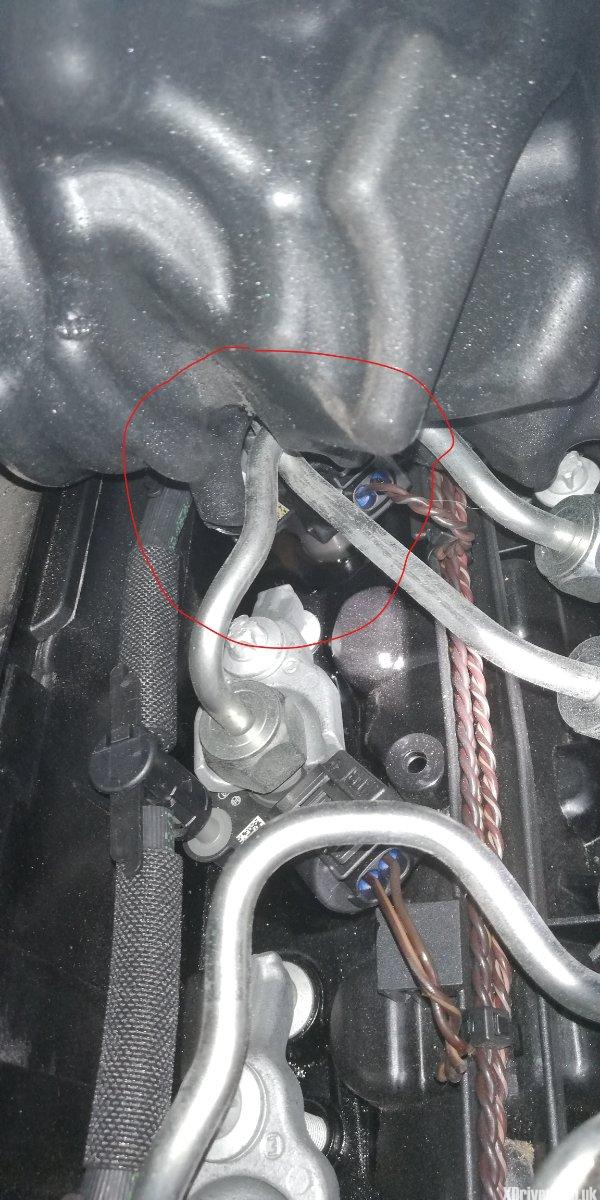

Quick update: Took off the engine cover and the foam cover on the injectors. Found a wet residue around each injector but on injector 4 it was a puddle/pool. It was brownish in color and did not have a particular smell. My initial thought was oil. See pictures

Post by marti » Sun Aug 09, 2020 2:30 pm
Possibilities are:
1.Injector seals leaking....ends up being called the black death....google it
2.Your scuttle panel seals are leaking water...happened on my X6 (2009) and knocked out 3 injectors as they are piezo ignited they dont like water :headbang:
