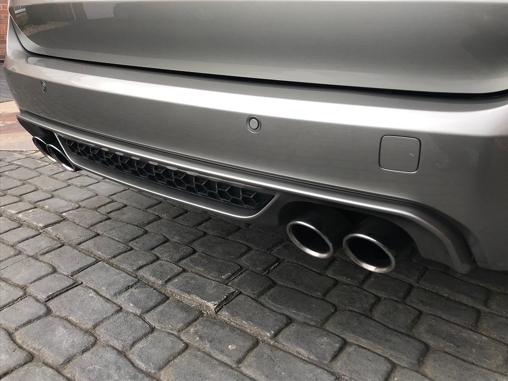

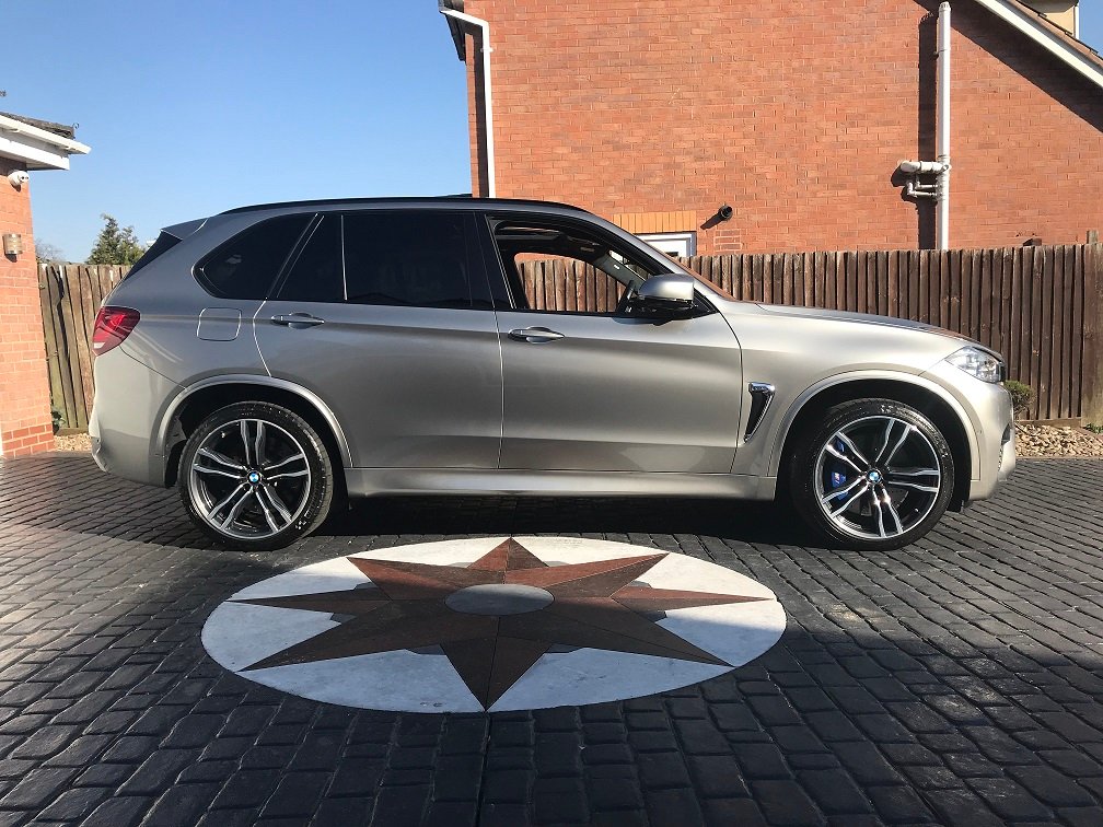

A couple of pictures of my X5M which is just about to go up for sale in case anybody maybe interested...... :)
d side.jpg (195.98 KiB) Viewed 4013 times
exhaust 2.jpg (162.77 KiB) Viewed 4013 times
