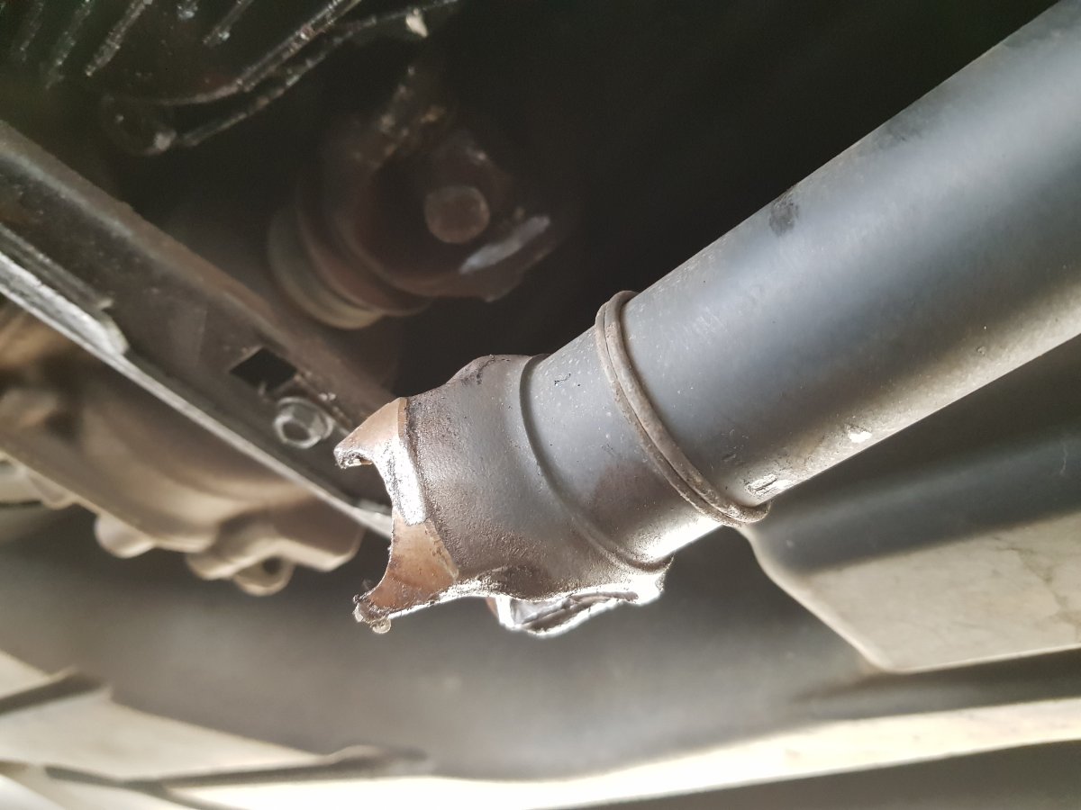

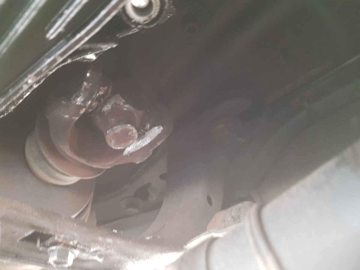

So had a crawl under the car today and the front prop-shaft has snapped at the joint nearest the transfer box. I now need to hunt down a shaft and cant help wondering what has caused the failure. I am aware that some cars had a recall on these but mine seems to have missed it. It seems to be 2011 cars.....strange

Wow! At least it didn’t flail about and wreck the bottom of the engine as has happened with some other victims of that failure.
That shaft it definitely the type that fails. Many were checked and found to be ‘acceptable’ only to fail later, in some cases BMW fixed them for free as long as they were being serviced by a main dealer.
New (revised version) part number is here: 26208605866
https://www.realoem.com/bmw/enUS/partxref?q=26208605866
There's a Febest version at around £165-175 In various on line stores. BMW want £800 for one

Having removed the shaft, the front joint is also just about to self destruct and barely intact. What surprises me is that there was no noise prior to the failure, other than a very slight noise minutes before it failed.
I have spoken to a local propshaft manufacturer who is going to rebuild it by welding new ends and balancing.
I now just have to remove all the plastic crap allowing access to check and see if the rear is in a similar state.
