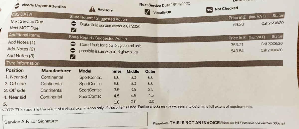

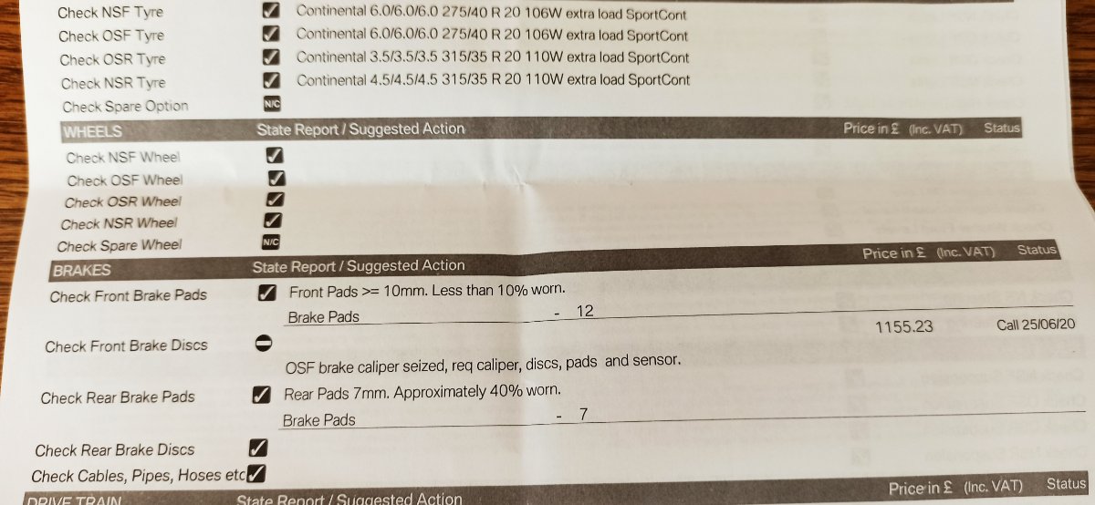

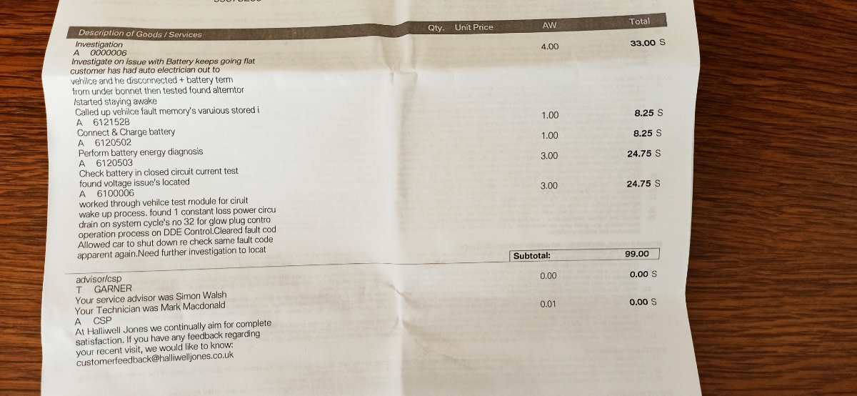

Update:
After phone calls with the main dealer I have collected the car and will be continuing the fix finding with a local top notch indie garage (Baymow) that are now back open, unfortunately they can't collect my car until next Tuesday.
The main dealer wanted to spend more time investigating around the glow plug module and cables etc.... Summed up by telling me it could be another £200 if just a harness cable or up to £900 approx if it's the GP module and Glow plug replacements!! This on top of ANOTHER hour of diagnostics @ £118! Was no guarantee of fixing my parasitic drain!![Image]()
I have attached 2 documents containing their report to date along with potential future costings to fix, was not willing to follow through with them, spent the 1hr diagnostics of £118.
FYI: They also quoted £1,155 just to replace a front O/S caliper, new front discs and pads!!! Indie quoted me circa £500 - 550 (genuine parts)!!

- Posts: 19249
Re: Parasitic drain possible alternator while sleeping?
That looks like the GPCU may indeed be dodgy, but their prices are ridiculous.
Pagid (OEM) discs are £96 each
Pad wear sensor = £12.25
Pagid (OEM) Front pads = £63 a set (4)
Remanu OSF caliper = £103.30 plus £35 surcharge refunded when old part returned.
Pagid DOT4 brake fluid = £5.78/ltr (you’ll need a couple)
Time to do the job = about 3 hours.
Prices from Carparts4less for a 40d X6 (same running gear on the E70).
They’ll also need 2 bolts that hold the OSF caliper to the car. These are single use and done up VERY tight. You don’t have to replace them, but the general advice is you should. They must have Threadlock Blue on them when out back in.
GPCU is about £80 with each plug around £15 (x6) and changed as a set (plugs & GPCU) because failed plugs will fail the GPCU.
Main Dealers really do take the p*ss but they prey on the unwary or unwilling.
