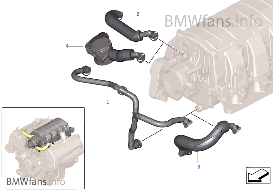

Re: 4.8 white smoke
This is the PCV
Also have you got any oil leaks, even minor. If you have an oil leak then you have a vacuum leak
