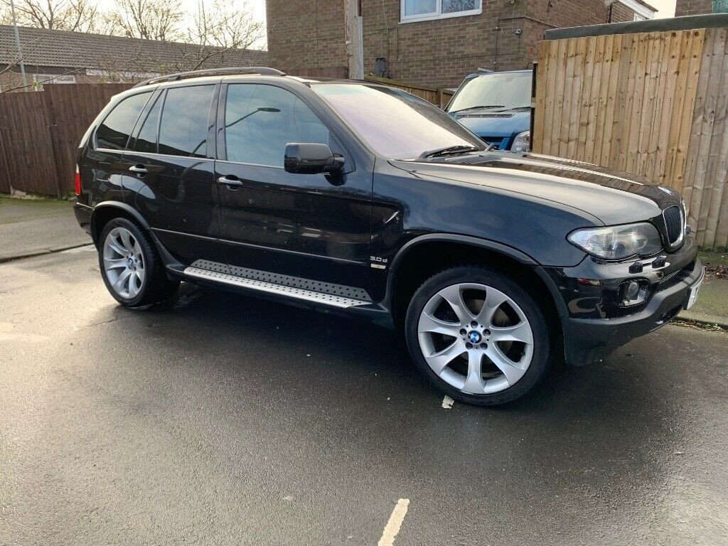

I recently bought a 2006 E35 3.0d with 130K with service history, 3 kets etc. See pictures (these are from the person advert):
