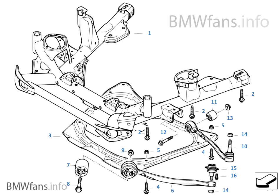

Posts: 1954
Re: Brakes
Post by henrym3 » Thu Jan 16, 2020 4:32 pm
Look at 6 and 14 for play
Posts: 1954
Re: Brakes
Post by henrym3 » Thu Jan 16, 2020 4:33 pm
Sorry 15 not 14

Post by Ceesums » Sun Jan 26, 2020 12:04 pm
I had the same issue on mine, changed the arm and ball joint on both sides, problem solved.
Cost of parts was £100. It took about 3 hours but worth it.
