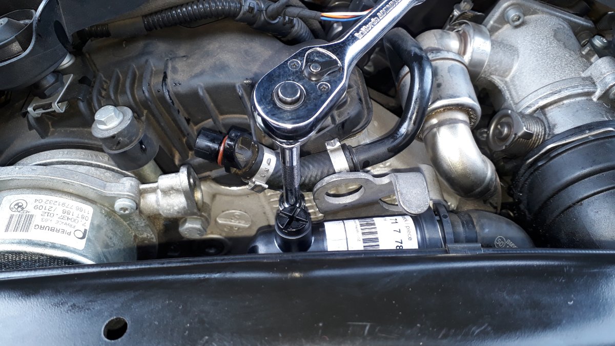

Well EGr stat changed ths morn ,of course a uk spec car is different than the us ones on youtube , the vacuum line is still right in the way and doesn't want to go back due to the engine lifting eye but cut a cable tie down the hard vac line to allow a little movement and got the inside 10mm out and the vac line pulled back.
It hasn't made much difference to temps so still needs main stat which is a much bigger job and means dropping the coolant.
Pic below shows vac line removed from pump and pulled back as far as it can go , not much room to get to 10mm bolt but 1/4 ratchet just fits.
