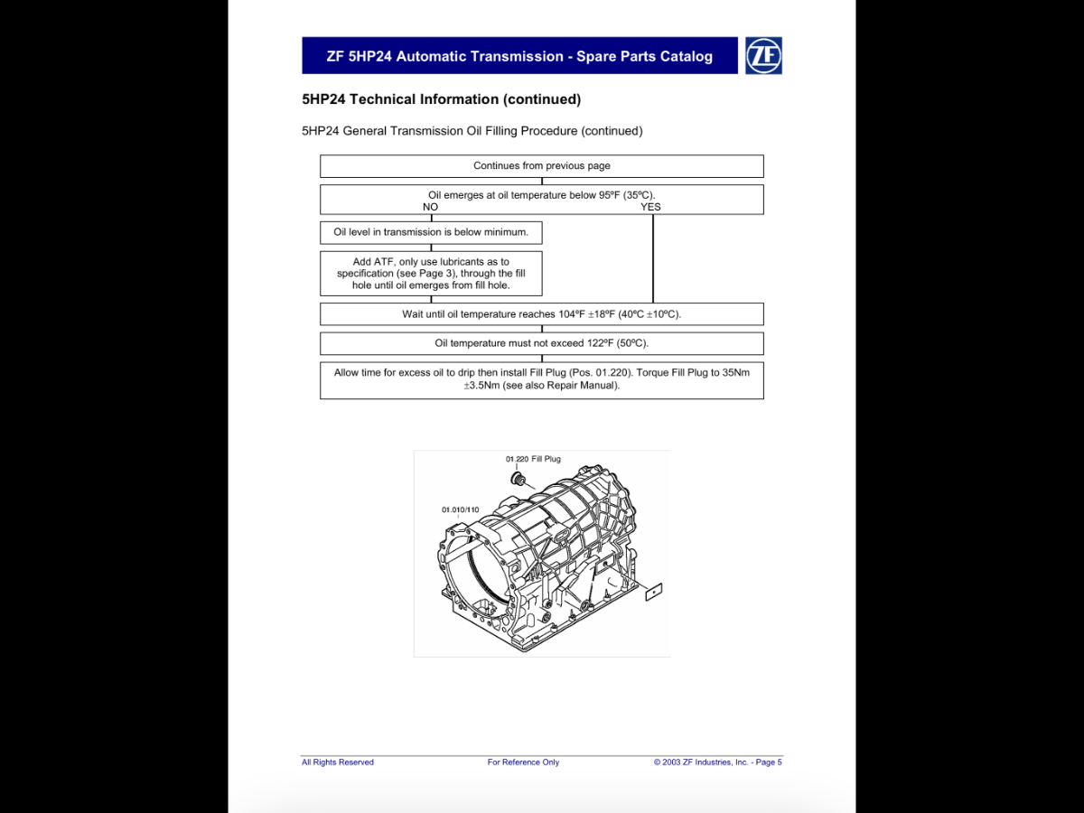

Gearbox filling procedure from ZF below if you fancy doing it yourself

Thank you for that :thumbsup:
It's a local transmission specialist that will be doing the oil change and Diff oil change.
He's previously done my Merc auto box, with good results.
