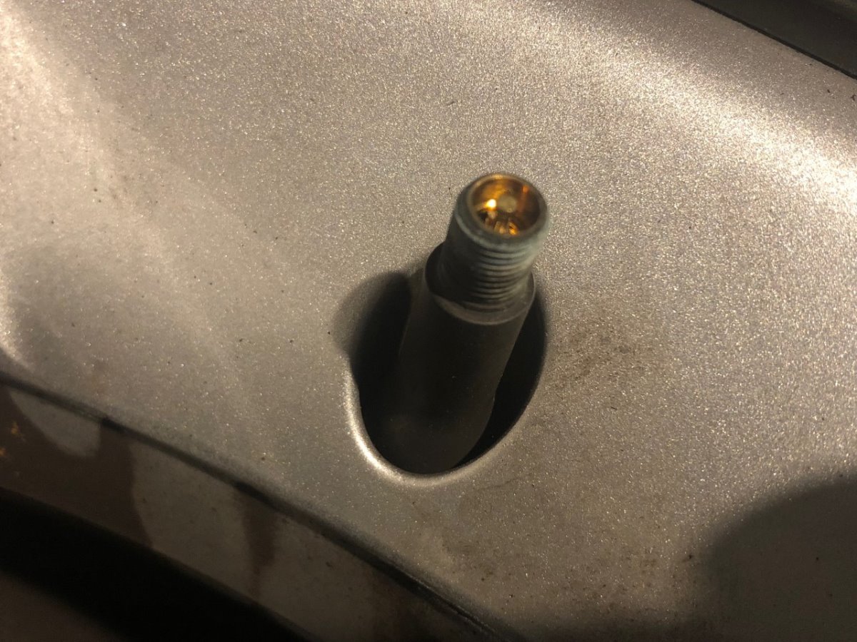

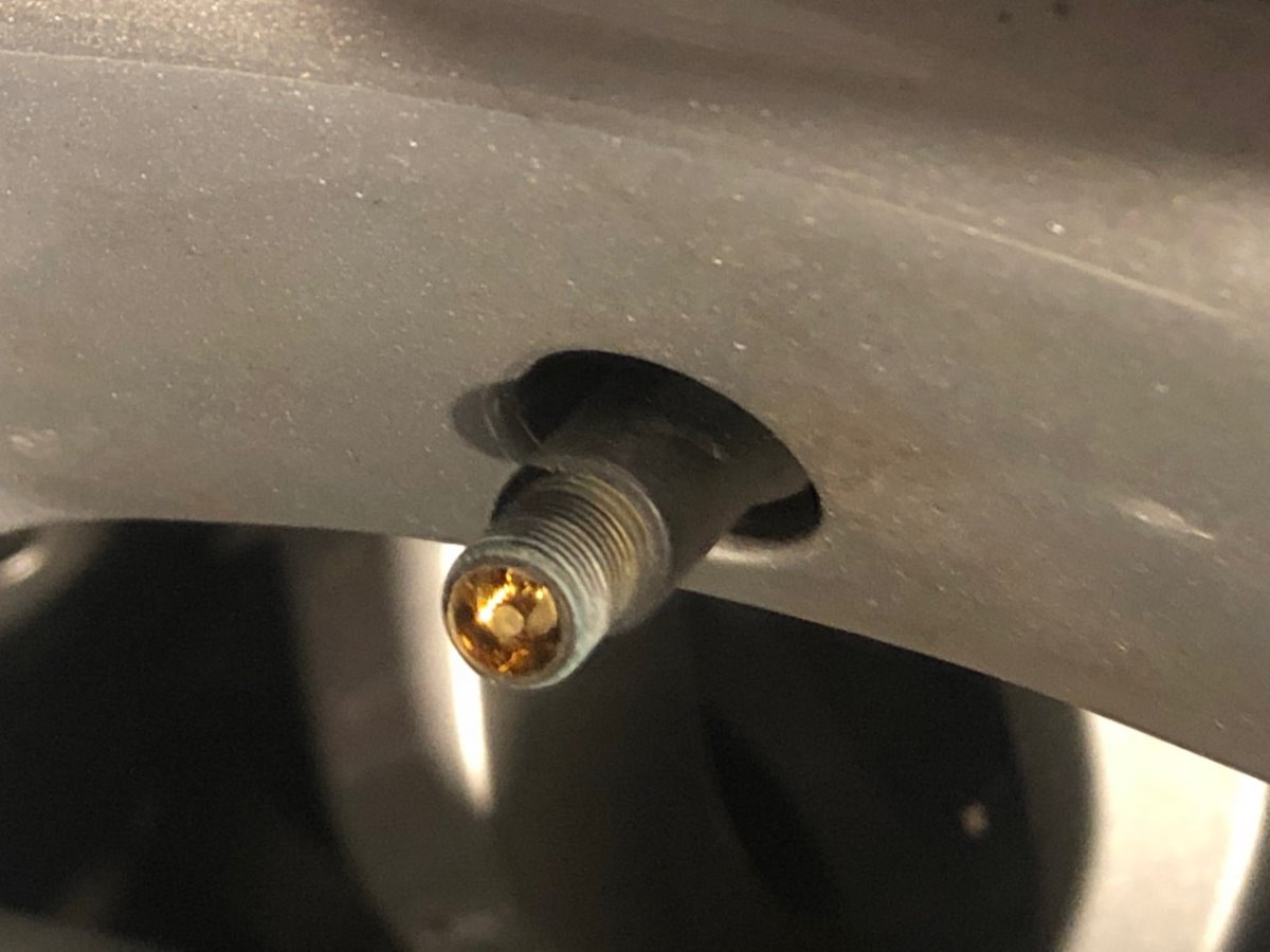

Hi Stuart,
See attached pics, what you reckon? Can only see the top half of the valve, the cap is grey however...
Any ideas?

Post by StuBeeDoo » Sun Sep 22, 2019 3:31 pm
That is undoubtedly a normal valve. No TPMS there!
