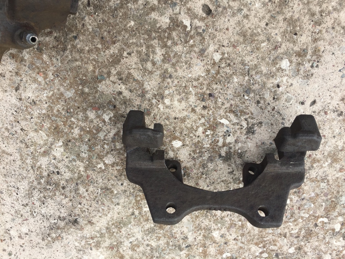

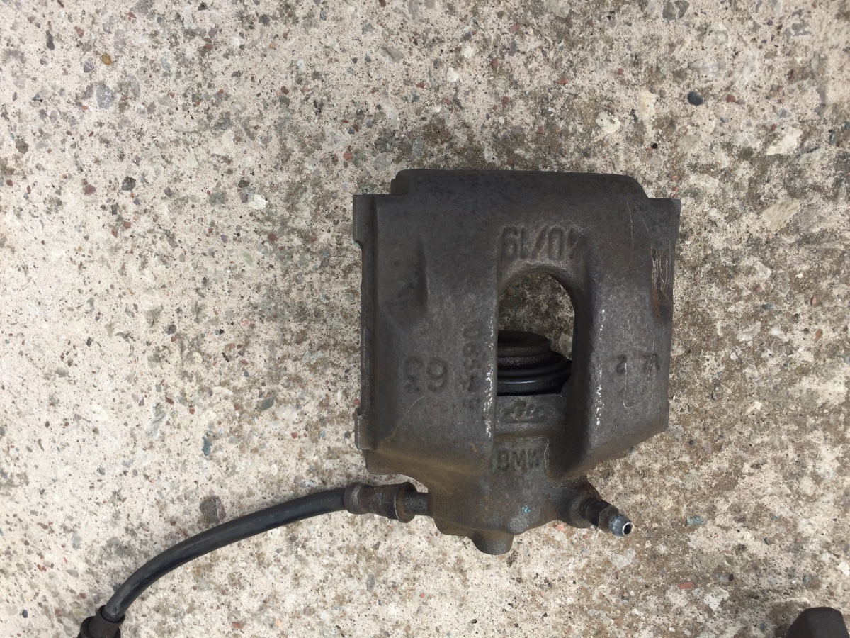

Thought I’d put up some pics of what you can do for 50p

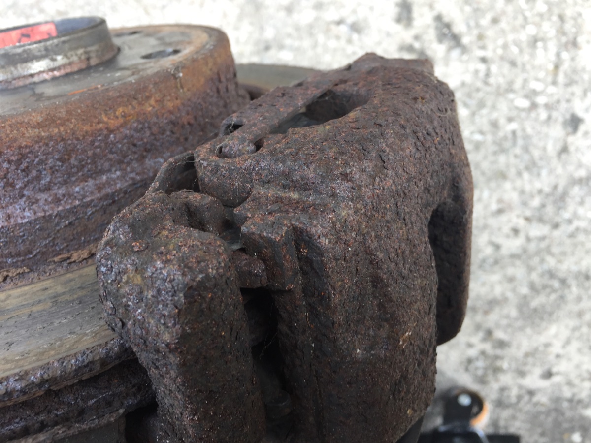

10 years in a dry garage. As I remove stuff to refurb I find the brake lines from midway down the car are just lines of rust, obviously need replaced however the car body is very clean. Don’t really know why if it involves the brake system it’s really bad and all other parts are fine.

Good result but wondering what the 50 pence was spent on ?

Re: Caliper
50 pence went to the Boy scout Henry paid to clean them up, and to think it used to be called "Bob a Job" week

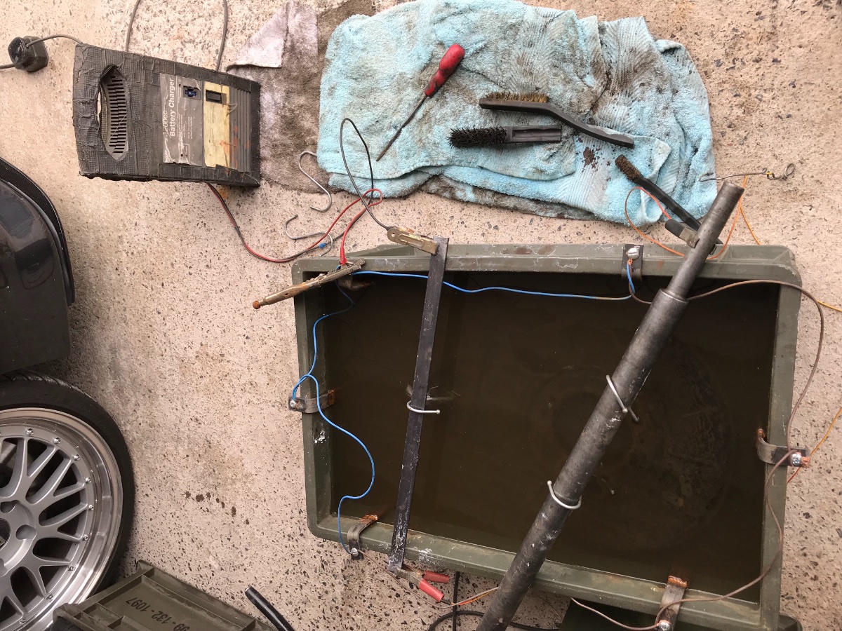

Re: Caliper
Well, I spent £1 but only used half the bag of Soda Crystals.
This is roughly after 24 hours, you can see the water is pretty grotty but you can also see that the rust has migrated from the caliper to the metal bars around the container

Re: Caliper
Glad you explained, I was worried that the Scout went in there.......
