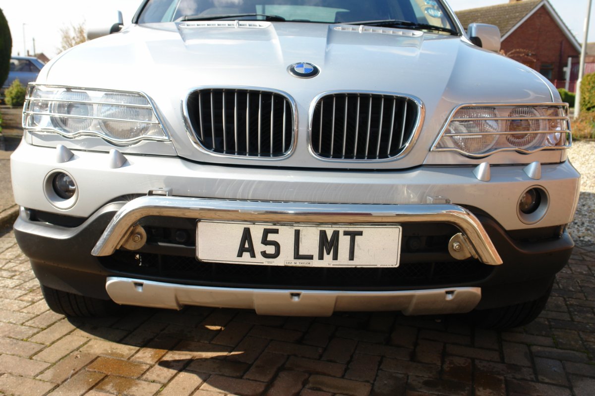

Post by lezmtaylor » Fri May 17, 2019 1:32 pm
I have a 2002 e53 with xenon lights, lights are the splitteble type so I have fitted halo led rings, been on 12 months and well pleased.
